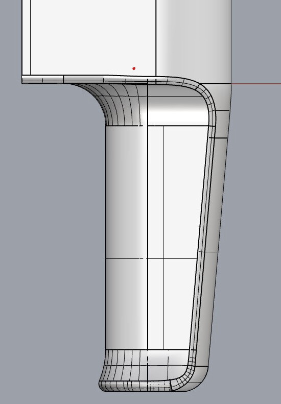

one detail i came across recently is the Braun 4402 hair dryer - one of my students worked on it
(the original real world object is even better…)
it is really a big deal to get this green fillet as precise as the original part - and i am quite sure there where many lime-(tree)-wood models to find the shape - i always wanted to fake some of those old models - two parts glued together and some precisely put filler - and i imagine a workshop, and the discussion between the designer and the model-maker… and they where driven by this very graphic perception. (which is great)
give a 2d-sketch of this object to young CAD-Modeller, tell the intent of this very graphic edge / small radius and for sure after 2 or 5 hours he will tell, this is geometrically not possible in 3d. Modelled with pure (circular / G1 / constant radius) Fillets it will look like this:
I am always wondering on the processes that where used before CAD / CAM / CNC to get those shapes end the corresponding injection molds…
This is how I think it was made.
Braun4402.3dm (537.0 KB)
Of course, in order to produce the same shape as the toolmaker, who created the mold for this part, one would need to have the same dimensions the toolmaker was given.

I agree with you, probably it was made like you did and then sanded to make it smooth,
In your construction this part could be improved:
It look wavy and, because it’s G1, it will shows in the reflection.
I like when the Rhinophile share their solution so this is mine:
Braun4402_RG.3dm (236.8 KB)
With a small chaet (blendSrf) only in the lower part of the handle.

Yes of course you can see from the reflections how this was made. It looks to me that the whole thing is composed of tangent arcs. If we had the same defined dimensions for those arcs we could model the part in Rhino as accurately as it was done in the 70’s.
When this part was made, the part manufacturer didn’t know or care anything about G1.
Arcs were used to define curved parts because they create aesthetically pleasing reflections and because they were easy to define in 2d drawings. Remember there is an inside to this part that has to fit with both the outside (wall thickness) and has to fit with the mechanical parts inside.
Nobody can manufacture a G1 surface transition. In order to make a highly polished surface transition that would reflect light the same as it does on a CAD model would require a manufacturing precision to 1/millionth of a MM or better. Nobody can do that.
When the mold for this part was made it was polished to give the part a fine surface finish, but that was done by experts who knew how to preserve the aesthetics of the way the part was designed.
