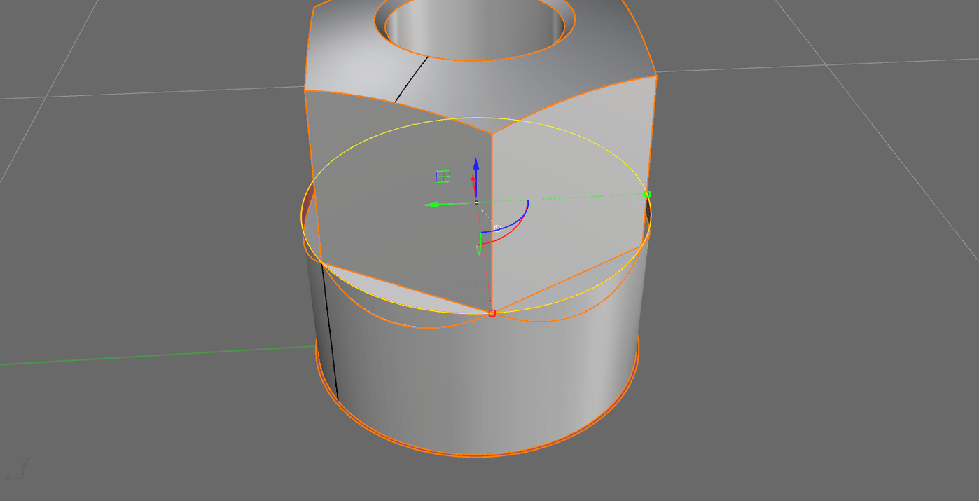

Ah, I didn’t really master the Project command (now realizing I could guide the project direction with mouse clicks). OK, the “§1 height” problem solved.
But the fillet width (pts 1 and 2 in your picture), how did you arrive at them? This fillet width didn’t “come natural” to me ( :slight_smile: ), but I understand that a suitable location for 1 & 2 is important for the horizontal edge to land at in order to avoid distorting the continuity. But how determine location 1 & 2?

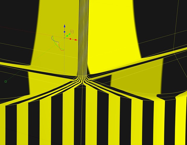

Yes it does affect but not that much.It depends on the situation. I’m trying to give it a smooth look. Edges should look relaxed. Like if you did a mesh relaxation. As said, I worked unclean there. I should have just created a blend curve “tan to pos”, creating a blendcurve with 3 points, creating a plane with three points and real trimmed the fillet at this plane. Instead I trimmed on the projected curve, that’s why its a bit wavy (last image). Anyway you can vary the location of the corners 1 and 2.
so, this works as well:
Good excercise this. :slight_smile:

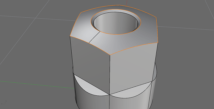

I would like to get some advice from @pascal @dan @John_Brock (or other McNeel boys and girls) on how to “fix” these fittings using Rhino Mac v5 (pending v6)
-Simon

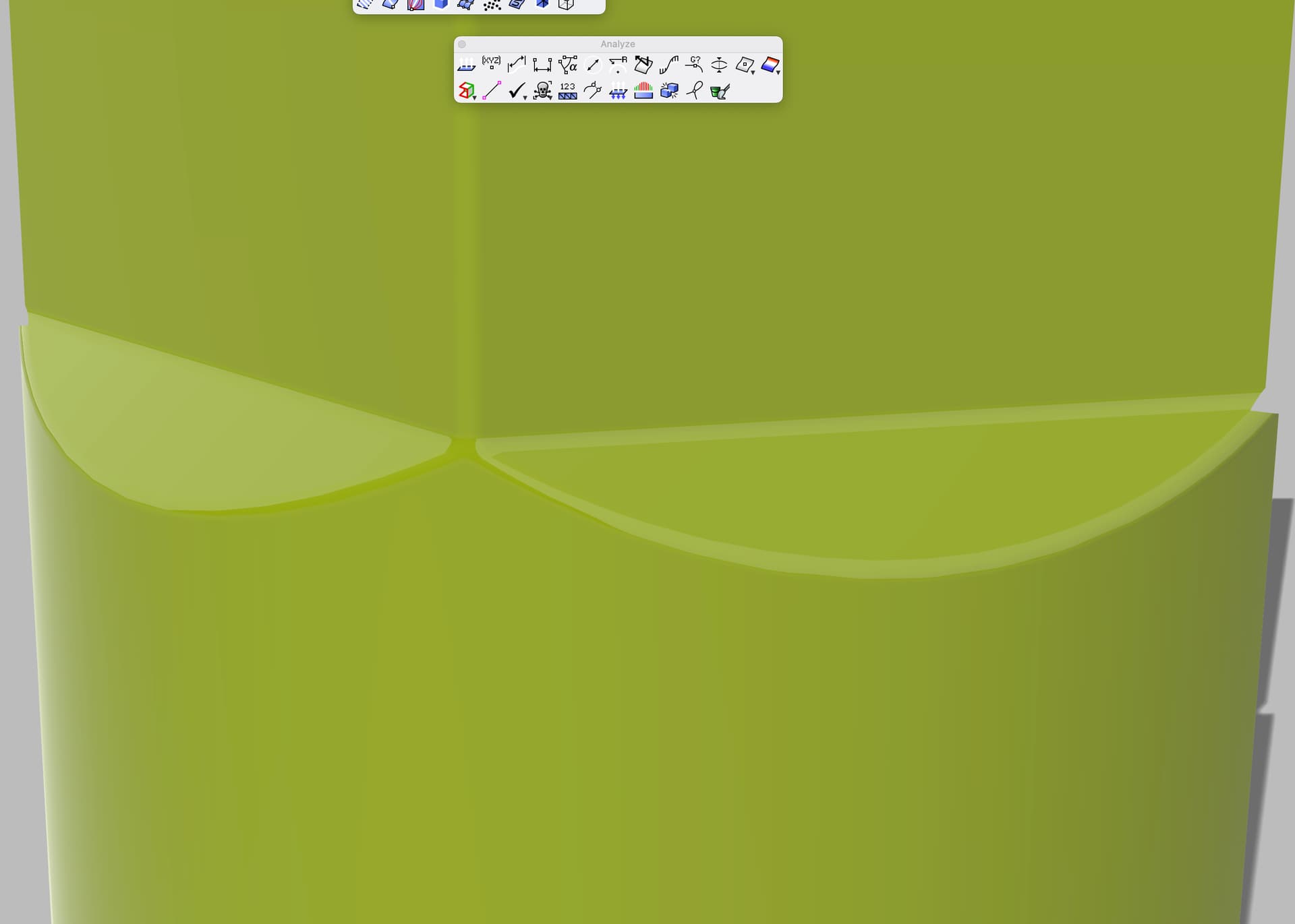

Thanks but in all honesty I do not like the result
-Simon

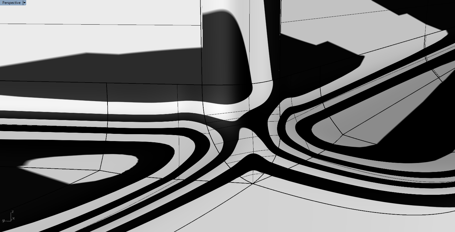

Better. Thank you
-Simon
