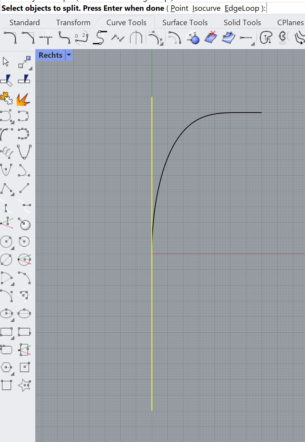

I have two lines like in this image, and I want to do an adjustable curve blend operation on them.
In the Adjustable Curve Blend dialogue I specify both ends to be G3 continous.
Next, I use the resulting curve to split the vertical line.
Now, if I check the resulting lower half of the vertical line and the blend curve for continuity, they are G2.
I had expected G3 continuity here, because I had specified G3 in the Adjustable Curve Blend dialogue.
Can somebody explain to me, why its G2, and, can anybody tell me what I can do to get this G3?

Hello, and thank you very much for your quick response.
I did the curvature graph, and I would say that looks good. The curvature smoothly goes down to zero at the transition to the straight line, which makes sense.
I realized, that Gcon lists the radius of curvature value as 0.00… . If I got that right, that already means it is G3. So it evaluates correctly, but then calls it G2.
cheers and best regards.
Frido
G3 means the rate of change of curvature with distance along the curve is continuous, along with curvature, tangent direction and position. Two curves can be G3 without the curvature being 0.
For the particular point in this example one of the curves is straight which means the curvature is 0 and the rate of change of curvature is also 0. The curvature graph appears to show the rate of change of curvature to be 0.
thank you for the clarification.
Given, that the curvature is approching 0 smoothly and reaches 0 at the point where the two curves meet, I consider them G3 and move on with them.
