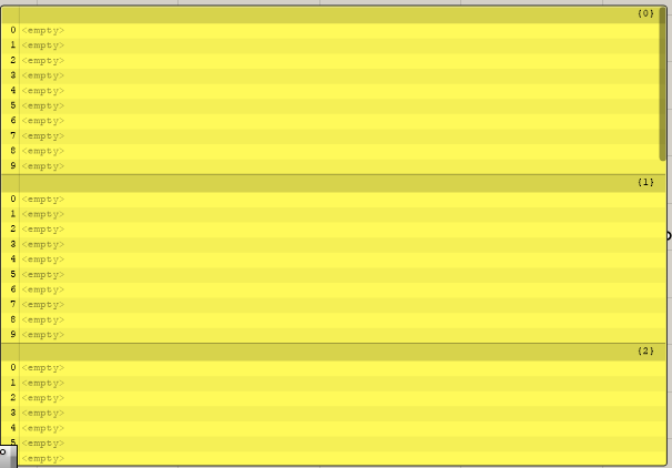

:cross_mark: The Problem:
Despite the script running without error, the output:
  • Has only 1 out put of strings structured like {0}0.
  • I tried changing input to item access, then the output becomes a data tree with {8}10 structure, and all items returns as empty.
  • It seems like I can only either obtain the data structure, or the content flattened as 1 string.
Any ideas what might have happened?

and the output I got:

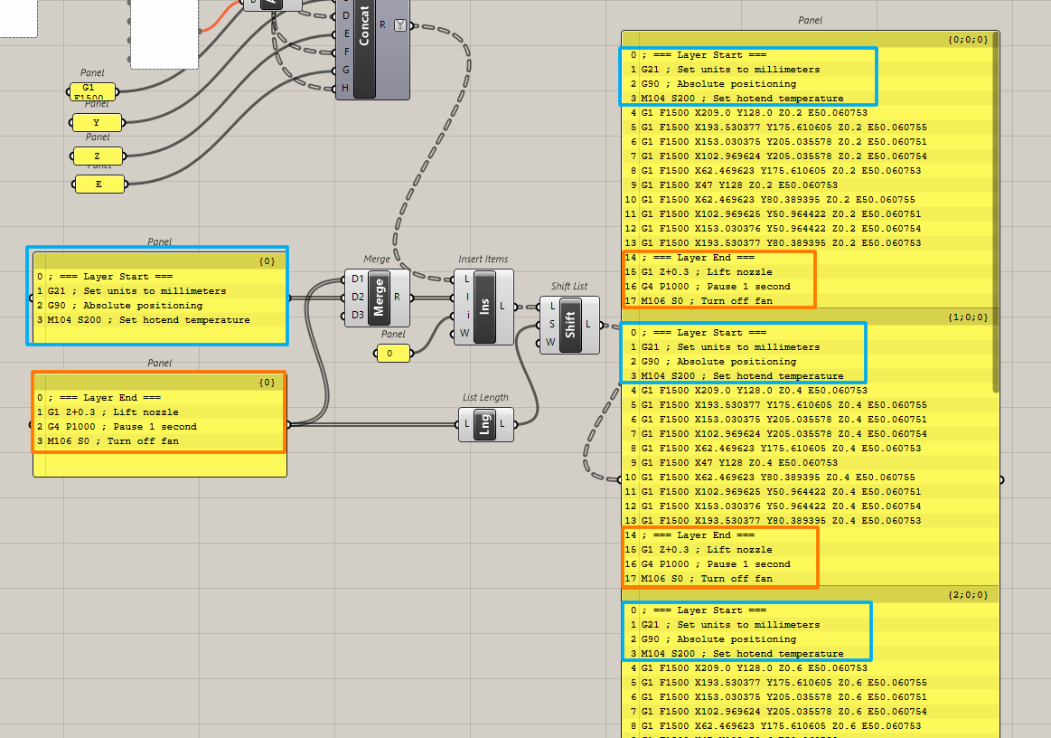

is there a particular reason you want to use Python to do that? it’s pretty straightforward with gh vanilla components:
test (7)_inno.gh (28.3 KB)
also not sure I would turn off fan at the end of each layer… for sure I would do that at the end of the print, but maybe not at the end of each layer
