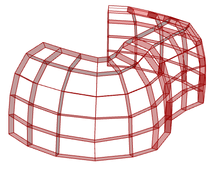

In “Isogonal moulding surfaces: A family of shapes for high node congruence in free-form structures” it classifies “Monge’s Surfaces” as conical PQ-meshes, a Monge in Rhino, from what I gather, being a Sweep with planar curves.
When I created this simple example and initially plugged it into conical offset (FaceFaceOffset) it does work, but when I increase of number of verticals and horizontals, it begins to break. I’m wondering if there is a problem with my method, that’s it’s not conical enough, or just not what the offset component is expecting.
I tried running the Monge through Conicalize and it does “fix” it to a point where FaceFaceOffset works but the edge boundaries are severely modified in the process.
When I use WeaverBird Offset Mesh it does look good but I’m still testing that and trying to sort the beams out to mimic the conical offset.
I feel like I’m close but not quite there, I’d appreciate your input. Piggy backing onto this thread because all conical posts inevitably point back here.
monge conical.gh (11.8 KB)
Hi @closedcurve
The mesh your file generates from this sweep is quite far from conical.
Here’s a file which measures the angles around each interior vertex.
monge conical.gh (18.4 KB)
On a conical mesh, each vertex must satisfy ω1 + ω3 = ω2 + ω4 (where ωi are the interior angles of the cyclically ordered surrounding faces). This shows they are up to 0.23 radians off. There will always be some amount of numerical error here because of floating point calculations, but if the process is right you’d expect to see several orders of magnitude less than this. I notice the quads are also visibly non planar.
So I’m guessing something is wrong in your implementation of the construction process described in that paper.
I can give some more examples of how you can use Kangaroo to optimize non conical meshes to make them conical if it helps (and keep boundaries in place while doing so), but it is different to a constructive approach (which gives up a bit of shape freedom but simplifies the process).

Initially I was using a Sweep2 with Quad Remesh but the results were not as clean as the paper, that’s when I tried to construct my own mesh from lines and likely ran into issues. I would like to create an authentic Monge’s Surface.
That said, I am interested in your example that retains boundaries, below is the conicalize method I’m using which seems to work but wrinkled the top and bottom edge quite a bit. The bottom edge being the most important.
monge conical2.gh (27.0 KB)
I’m somewhat familiar with the more restrictive methods, you have to work very hard to come up with an organic, asymmetric shape that sits nicely on the ground. The Monge’s Surface paper really excited me because it seems like a way to generate a conical free-form wall or walled-enclosure from just a few wavy curves.
To keep the top and bottom edges flat you could do something like this:
monge conical2.gh (36.3 KB)

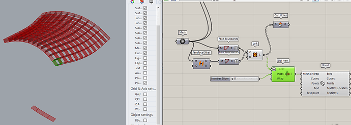

I have been working recently in the conical mesh topic and I notice that after applying the offset mesh component from kangaroo2, to a conical mesh, the edges of the resulting beams structure are not planar so I applied a planarity optimization to this beams structure and now they are planar but the nodes are no longer centered on the original conical mesh normals.
ARCHITECTURAL STRUCTURE PLANARITY.gh (81.9 KB)
I had the same planarity issues at the edges with different geometries after applying the offset component.
So I would like to know:
1.- Why the edges of the resulting beam mesh are not planar or if this is a bug.
2.- How I can obtain all the planar beams including those at the edges without displacing the node from the normals of the conical mesh.
Thank you very much for your time.

Hi @dannysantiagovi
I see you’re talking about the beams at the naked boundary.
The issue is that conicality is defined and optimised for here as an angle condition on the 2 pairs of opposite faces around a vertex, but the naked vertices don’t have pairs of opposite faces.
The way I’ve generally used it if I need beams for a mesh with boundary is to include an extra outer ring of faces in the optimisation, then discard them later. This way all the vertices actually used are fully surrounded by faces during the optimisation and offset generation.
(I find this general approach of using a ‘skirt’ during optimisation, then trimming it off after comes in handy for other types of mesh optimisation too)
Let me know if that isn’t a workable solution for you though. I think it would be possible with some small changes to optimise for naked vertices too if needed.
