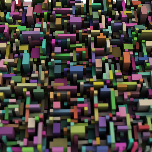

A script to assign a random colour for selected items? [Keyshot export]
Hey guys, trying out the polyhedra plugin which would could create polyhedra with different colours. This comes very handy when quickly assigning materials in Keyshot.
So maybe you know some workaround for this:
  1. select several objects (surfaces, polysurfaces etc) and then assign a random colour which wouldn’t reoccur if select and assign other objects to kind of pre organize the scene before exporting to Keyshot. Would save a bunch of time. Hope you know something.
Thanks a lot and have relaxed Sunday evening to you all! Hannes

@pascal my hero! I finally figured out what would be great approach:
  1. A script for a random material (because someone can evaluate the overall look within Rhino first)
  2. a script for selecting all parts with the same material ID so I could handle them better (e.g. select all objects with one material and then deselect some parts and reassign, or assign to a layer)
What do you think? What be awesome since I’m getting my hands deeply into contemporary Arabic designs and the included pattern designs. This would be a game changer within Rhino.

Hi Hannes,
below is some very old rvb script which still seems to work in V5 (Windows only), since i do not have the time to rewrite it in python tonight. Note that by default it assigns colors to object (wireframe) color and material color. So be careful, eg. running it on 100 objects may create 100 different materials unless you disable the option “MaterialColor” in the command prompt.
There are various options, color gradients, brighten, darken, random color, random greyscale, reset color source …

this is a result from the “RandomColor” option:

Hmmm… This is really helpful. Keyshot clown passes often use very similar colours. Applying random colours to a multitude of objects before export is really helpful as another layer for masking.

@clement I gave it a try but it would only color all selected objects in a random color each.
What I originally wanted for keyshot is a quick and easy material or color organisation within Rhino for quick overview and further for export to Keyshot.
So it would be rather very straigtforward if there was
  1. a single solution/script for just selecting objects and fire a command to colour them all in a random material colour. toggling material and display colour as options would be nice but not necessary
  2. a solution/script to select one object and fire script and get all items selected with same MatColour
What do you think?
As you see all selected surfaces got a random colour each :frowning:

@hannesgrebin, below are some scripts to assign one random color value to selected objects. One script for object wireframe color and one for material color. Note that the material color script also assigns a material name, to get rid of this look at the annotatons in the script.
RandomObjectColor.py (557 Bytes)
RandomMaterialColor.py (912 Bytes)
To select objects with the same material color(s) as the selected object(s), you might try this:
SelectMaterialColor.py (874 Bytes)
