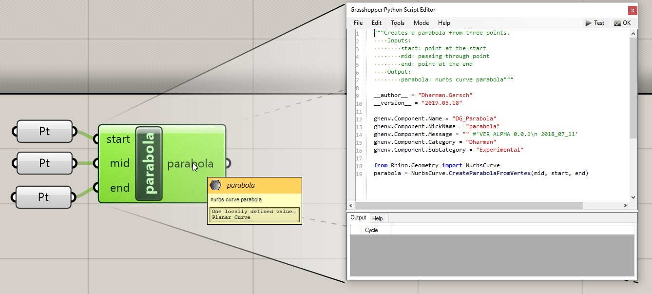

In Rhino there is a command to build a parabola from 3 points, how can i do that in grasshopper? Or at least a parabola controlling the distance between the 2 upper points and the distance of the vertex at the bottom

It’s my first time with c# scripting so i don’t know how to correctly insert the code. I putted the type hint of the inputs as “Point 3D” but don’t know how to continue
here, i’ve done it in python for you.
parabola.gh (3.9 KB)
… and in C#:
