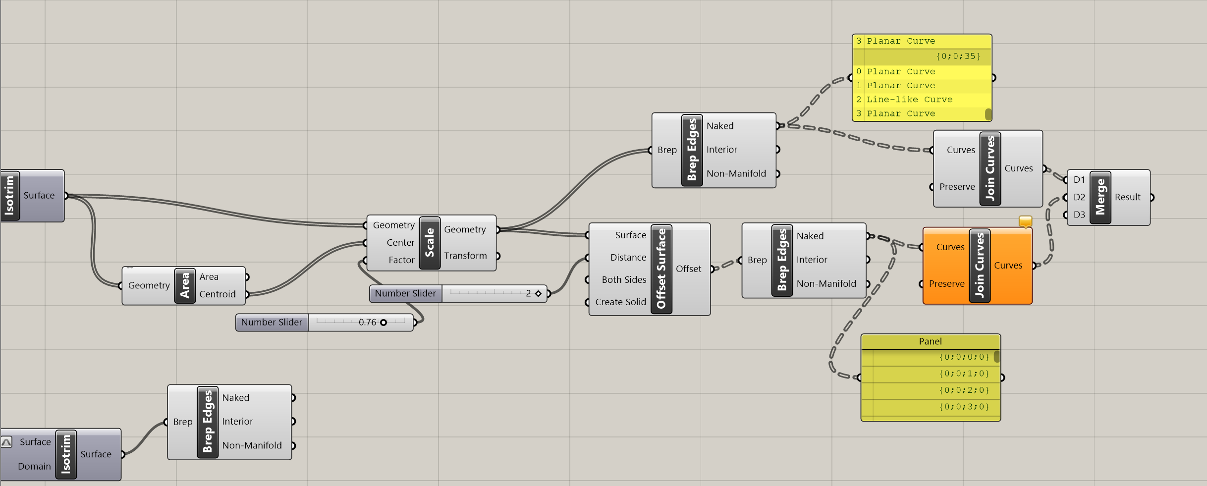

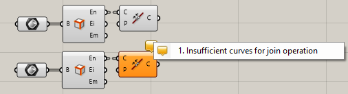

The orange component says insufficient curves for join operation.
If [Create Solid] is true, NakedEdge cannot be obtained.
Please upload your .gh file so we can have a look (internalise data first)
For what I can see now:
  • Flatten input Curves on Join Curves
  • The endpoints of the curves need to touch eachother otherwise they will not join.
Regards, Eef
Edges can always be accessed by using Deconstruct Brep
Regards, Eef
Dag Eef -
Depending on the details, flattening curves might not lead to the expected polycurves here.
Yes. In this case, though, the Brep Edges component was used and when the brep is closed, there are no naked edges.
That, to me, is the most likely scenario here.
But as you say, we’d need the .gh file with internalized Rhino data to be sure.

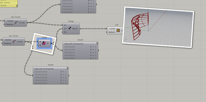

shiftpath before join curve

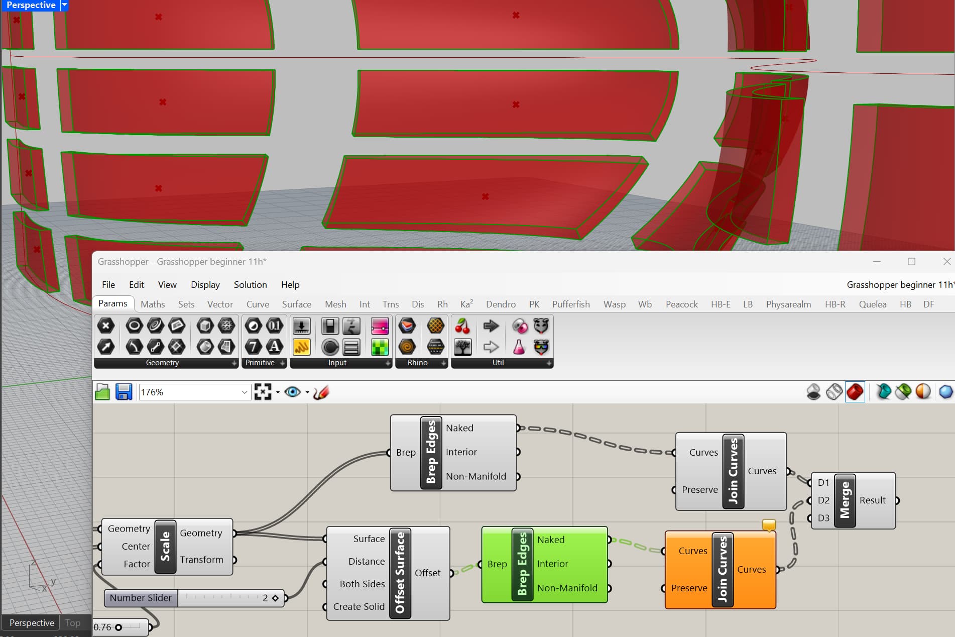

Hi all, thanks for your responses. While making create solid false turned off the error message, now the loft component says 1. Loft could not be constructed. here is my grasshopper file. The script is at the bottom right corner.
Grasshopper beginner 11h.gh (555.6 KB)
shiftpath to match the tree structure or trim tree
Ok thanks! can i ask what went wrong and how did shiftpath help with that?
to match the data with the above curve
i used shiftpath or trimtree can also be used
