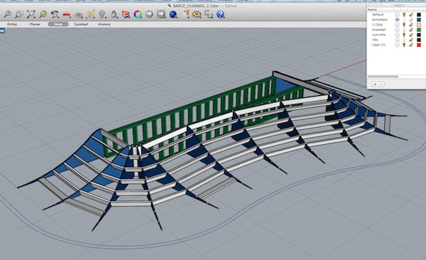

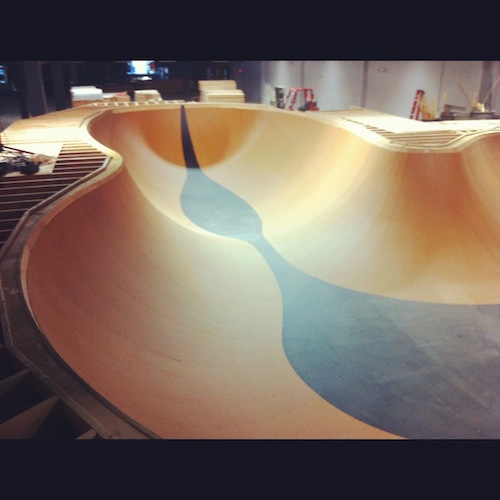

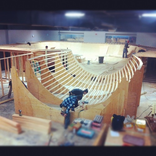

a few screenshots/snapshots:

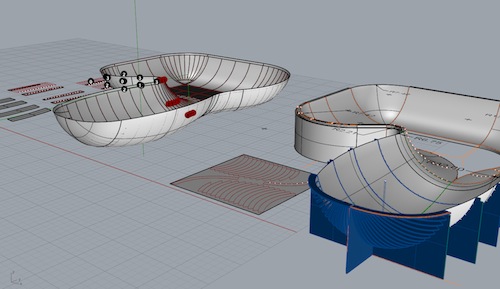

(absolutely loving the smash command for this type of stuff… it’s made my life much easier :wink:
this project from earlier this summer had some production companies in the mix and it was agreed all the info would be shared via sketchup files since everyone had it… but everything from my side was done in rhino then either compiled in sketchup for the visuals or sent to the engineers as the actual .3dms

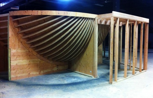

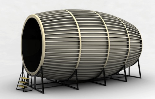

i don’t have a complete rendering solution right now through rhino itself but i still manage to get some pseudo clay style things out of mac rhino’s toucan which do the trick… this is my current project which is (hopefully) going inside someone’s house
anyway… the answer to your question from me is yes, absolutely… though it may be in a way that doesn’t really conform to typical architectural standards etc…

How do you find the Smash command for accuracy when the panels are CNC cut? Is there a bit of site shaving and gap-filling required at this scale?
yes, there is… in the past, there was lots of shaving/fitting as it was moreorless a guess for me at getting those shapes… but now, it’s one cut if i’m going for ultratight fits… (i use three layers of surfacing… smash gives me totally fine results for layers 1&2 then i cut them to fit for the final layer)…
what i do is put two saw blades on one saw giving me a little over 1/8" kerf (these newfangled ‘thin kerf blades’ made me start doing this :wink: )… i’ll mount one sheets then temp tack the adjacent one in place which will have 1/16" gaps in spots… i’ll run the blade the entire length giving a consistent gap then butt the two together…
so with smash, it’s one cut for me… it used to be a bunch of tracing and cutting then the final fit cut…
in all reality, the initial gaps are fine for my use without the additional cut but i like to do it anyway :smile:

well, it may be a little misleading the way i’ve presented it (i.e. smash = 1/16" give or take)… i’m sure if i smashed an 1/8 sphere as one, the error would be a lot more noticeable… but with the materials i use the command with (1/2" plywood or 1/4" phenolic resin) i have to divide the shape into smaller pieces or the material won’t bend in multiple directions… an 8th sphere of say, 7’-6 radius will require approx 10 individual petals so each individual piece will have a lot less of an error than if i flattened the entire surface as one…
