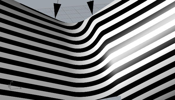

Hi Tone- make sure you check the surfaces (Zebra, with a very fine anlaysis mesh) not the edge curves.

I did check with the zebra stripes but it was seeing a test render that made me check the ‘G’ on the edge curves. The shadows in the render are wrong for something that is supposed to be smooth. It looks like there is a bump followed by a dip (G3 and G4 too). What’s wrong with checking the edge curves?
Hi Tone- nothing wrong exactly with checking edge curves, but it does not tell you anything about the surface continuity- it is perfectly possible and even common to have edges that meet at an angle when the surfaces are nice and G-whatever and vice-versa.
Yes, I understand that but I think in this particular case they should read G2 (the curves sit on the same plane). Anyway the shadows look visually wrong.
Hi Tone - Well, the the normal to the blended edge there is not, quite, in the plane of the long, straight adjacent edges, so there is no way for the blend surface edge curve, which pays no attention to the adjacent edges at all, only to being normal to the input edge by default, is going to be G2 to those edges, Does that make sense?

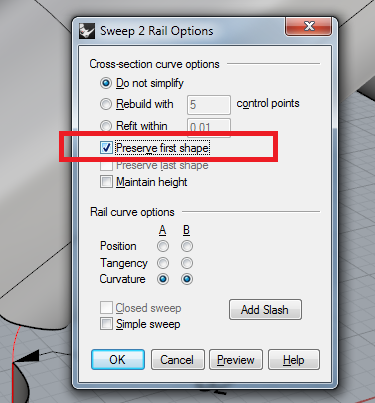

Can’t you use the sweep2 command with the Preserve first shape to keep G2 at the edge crv.

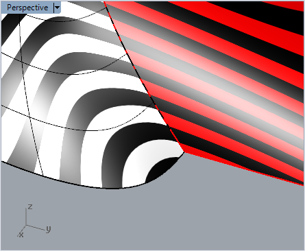

@tone I also would have expected the same thing, that the edge curve blend would have been same continuity as the surface bend since the both edges are straight, lay on the same plane, and both pipe surfaces are have the same curvature. Still trying to wrap my brain around how they can’t be.
@pascal I think I understand your post now. If the blend edge of the pipe was straight, or perpendicular (normal) to the curvature of the pipe, then it would and it does create a G2 edge curve. Like this
But since the edge of the pipe surface has been trim across the surface (slightly) then the blend curve curvature isn’t normal to edge curve. If that makes any sense.
So when you run the blendSrf command, like you said, it doesn’t pay attention to adjacent curves, but if you put a G2 blend edge curve there and run the sweep2 command then you can achieve it.
Hi Dennis- that is what I was getting at, yes- you can achieve it but not (directly) because of anything BlendSrf is doing…
