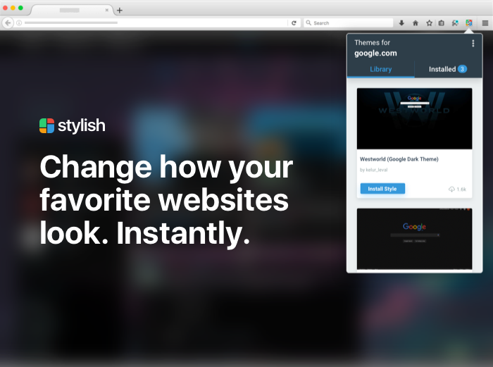

Some have been wishing for a more minimal, more compact display for Discourse. @sam suggested that we try out the Stylish plug-in for Google Chrome to see if we can make something that works better for us.
Here’s my first attempt at something that I personally wouldn’t use, but may work for those of you who wish for something more minimal. Currently it only styles the topic list, not the discussion.
Download Stylish and then create a new style called Discourse Compact, and apply it to only URLs on the domain “discourse.mcneel.com”.
Then paste this code and click Save:

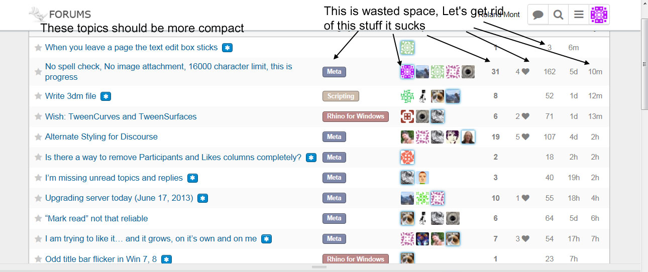

How do you figure out what to put in this? For example, here’s a couple of things that I would like to change:
  • Hide “Activity” columns.
  • Make a bigger color difference between read

Please remove the circles around Category so it doesn’t get more attention than the topic, and condence the “posts, views, activity” bit, and we are on the way to sucsess! (And swap the heart for a hitchikin thumb in the air)
I also think that Topic should get more space, so longer topics could be read on one line.

There is a Stylish plug-in for Firefox as well.
Yes. I am running stylish in Firefox:

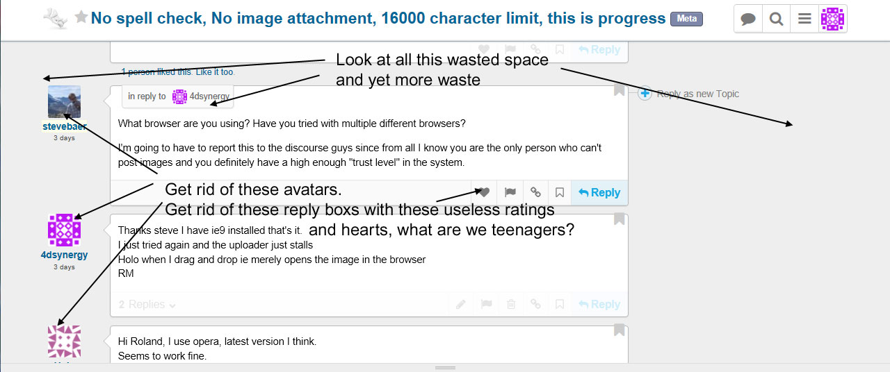

Can’t Mcneel remove most of the icons? I really find them useless and distracting, avatars are wasted space let’s be mature and remove avatars from this forum.
Please also remove:
Participants, posts, likes, views and activity, this is all useless.
Having to open each thread in a window where we scroll down is hardly effective. If you really want to make this forum rock please remove all this needless fluff. I don’t see why we have to have all those icons under each reply as well. I appreciate your hard work on this and I hope you guys take this seriously, as I still think discourse is not an improvement in usability over the newsgroup.
Thanks I hope this place can be made nice and user-friendly.
RM
