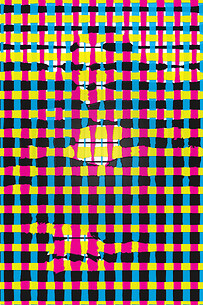

Hey everyone! I’m trying to comprehend all the program’s subtleties in my creative research at the moment. Currently looking for a method of processing xylography style images (just like in the picture):
Looking for .gh file or a link to a similar forum topic.
In the future, I plan to implement the idea of weaving color pictures with this method:
I am new to programming, so I will also be grateful for your help

Some improvments, each channel look at a color (red, blue, green, brightness)
Parilyn Andy Warhol
Great job!
I wrote a similar filter for Photoshop at the time. You should play with stripe minimal thickness, layers order and also try CMYK insted of RGB
Now I’m gonna wait for 25 years when your .gh file will be declassified and you’ll share it :slight_smile:
I can share my file but it is just some C# doing mesh strip or sort of mesh tubes. I finished by using distance betweens colors to adjust the thickness of lines, yes there is a minimal distance. There could be many options.
Anyway, I don’t understand how you weaved them in 3D. You are probably a hacker
Please, share!
So, how did you manage to create a weaving structure? Suppose I have a set of vector lines in 4 basic colors (or what do I need). What’s next, master?
i think he’s using one rgb channel horizontal and another vertical, the yellow is background or could be 3rd channel or greyscale of the bitmap. That part is kind of easy and weaving is a cull pattern up or down.

Here the script, there are quite a lot of sliders but as it is fast it will be not difficult to understand how it works. It could surely be done with GH components but it is faster for me to code.
The logic is simple.
Draw “lines” in X and Y, deconstruct each line in nn points, look at the color at each point and then measure the distance from a defined color (even stripe has a color, uneven stripe another color). As a color is a sort of 3d point I use the Point3d euclidian distance metrics.
Weaving is very simple, it is just a Sinus. Hope you know this function.
Provide :
A filename of the image you want
4 colors
color of uneven vertical stripe
color of even vertical stripe
color of uneven horizontal stripe
color of even horizontal stripe
number of vertical stripes
number of horizontal stripes
number of subdivision along the stripe
factor of multiplications of stripes (> 1 can overlap)
a bool if you want to invert
distance from the color, the max distance is sqrt(3) = 1.7
relative height of weaving
min relative width of strips
a toggle if you want to make tubes
parameters of the colors using Joseph @Joseph_Oster component
That’s all.
2.5D
3D
Xylography.gh (26.8 KB)

Thank you very much for the professional detailed answer - quick, accurate and concise. With legible illustrations.
I was initially confused by this picture:
4c662f200883e7255561e18418fcfbd106a864e7_2_544x500
It looked like the stripes were tightly woven - I did this in 3ds max using various physical simulators, but it required prohibitively high computing power. And you’re definitely a hacker!
You could get that by using Catmull&Clark (from Weavebird plugin) subdivision from 3d mesh and play with the internal value named
float heightFactor = 1.6f;//
The bigger the more close the tubes will be.
Slider relative height will allow you to flatten the tubes.
