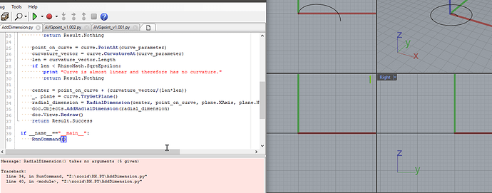

do you particularly need that text dot?
Funny thing about this RadialDimension example was that you copy paste it directly. Run it it asks you to select a curve. You comply, and then it throws an error. :smiley:
How reliable should the examples in the API be?

Although, this is a bad python example:
from Rhino import *
from Rhino.DocObjects import *
from Rhino.Commands import *
from Rhino.Geometry import *
from Rhino.Input import *
from scriptcontext import doc

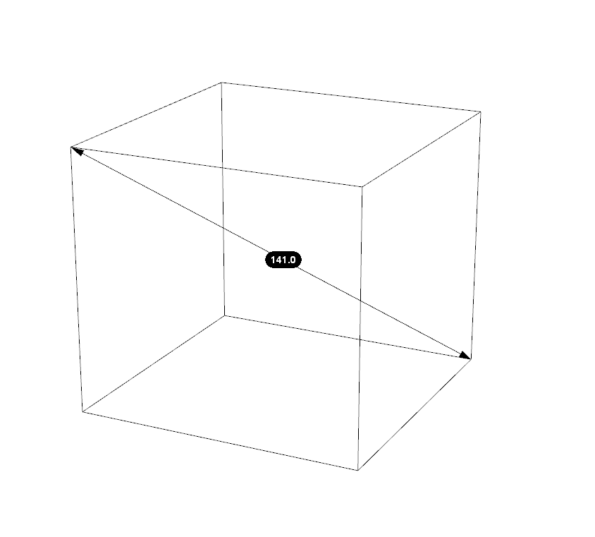

Try something like this :
Call Distbetween()
Sub Distbetween()
	Dim pt,pt2,dist,units,prec,msg, arrLine
	pt = Rhino.GetPoint("Pick point On object")
	If Not IsArray(pt) Then Exit Sub
	pt2 = Rhino.GetPoint("Pick point On object")
	dist = Rhino.Distance(pt, pt2)
	arrLine = Rhino.AddLine(pt, pt2)
	Call Rhino.CurveArrows(arrLine, 3)
	units = Rhino.UnitSystemName(, True)
	prec = Rhino.UnitDistanceDisplayPrecision()
	msg = "Distance between points is "
	Rhino.AddTextDot Cstr(Round(dist, prec)), Rhino.PointDivide(Rhino.PointAdd(pt, pt2), 2)
	Call Rhino.Print(msg & Cstr(Round(dist, prec)) & " " & units)
End Sub
many thanks! :bowing_man:

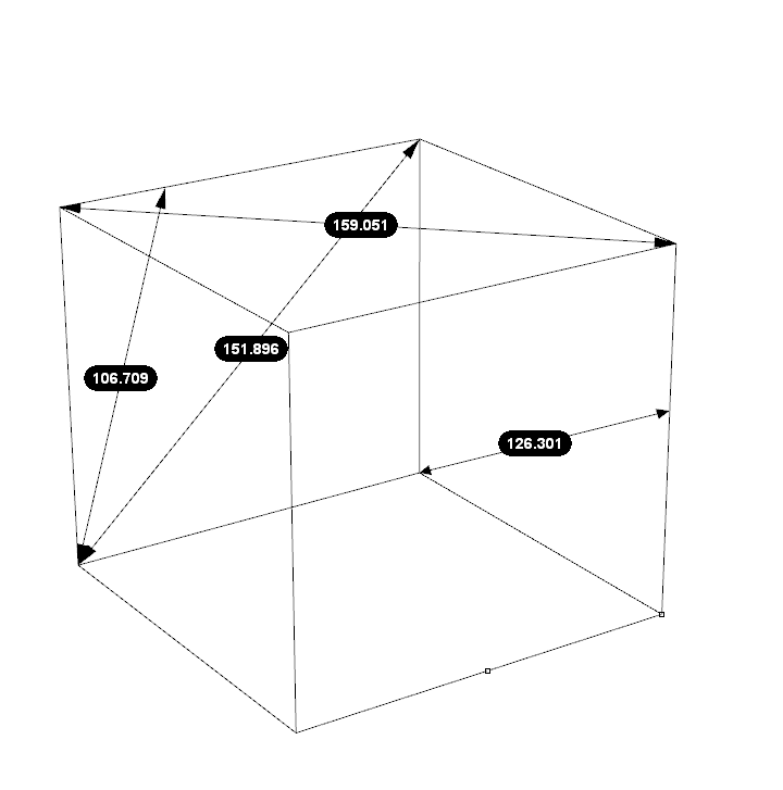

just to share the script with everyone:
I’ve changed the input method to getLine for more feedback and grouped the output
use at your own risk :wink:
distance
