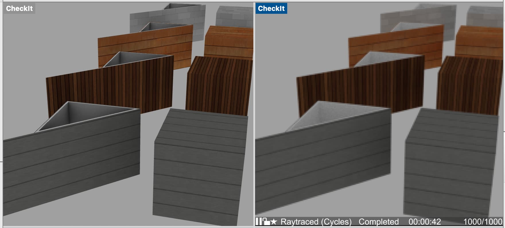

Object with Box mapping applied, made into a block, instanced twice. Rhino 7 Raytraced and Rhino Render do this correctly with raytracing. (left viewport is Raytraced, right viewport is Rendered, then there is the _Render render window using Rhino Render)
As far as I know, there are raytracing engines in Rhino that support WCS mapping materials, like Rhino Render or V-Ray.

Your file shows the same in Raytraced and Rendered mode for WCS/OCS Box style.
This works as expected.

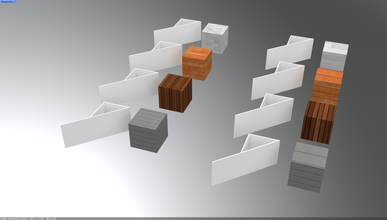

are you using visualARQ? because the triangle-shaped objects are walls and here is what they look like in Raytraced mode on my computer.
I included the same objects with Map Channel 1 because the mapping was being rendered differently in Enscape between “materials” set to mapping channel 1 and “materials” having WCS/OSC Box Style
This is VRAY:
This is Enscape:
Notice how the scaling of the material on the box-mapped objects does not match the scaling in the viewport.
