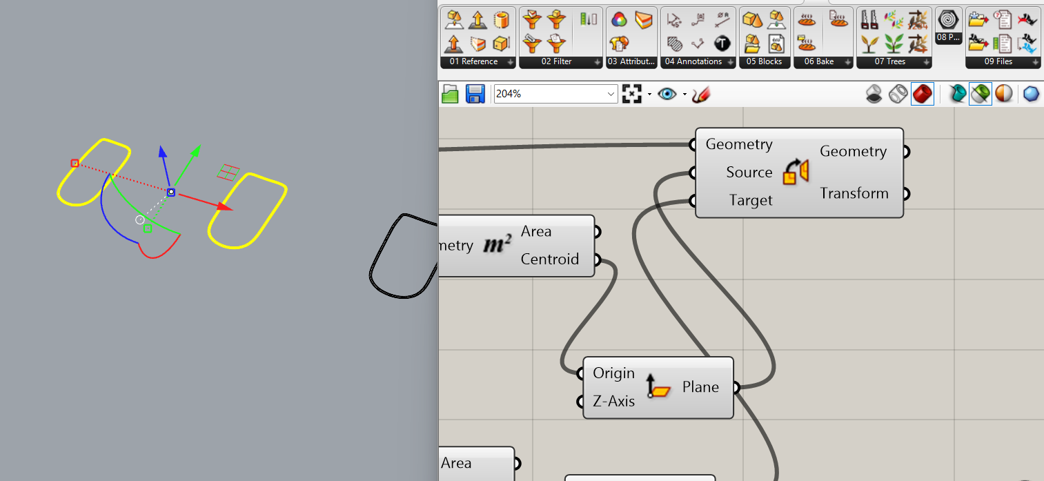

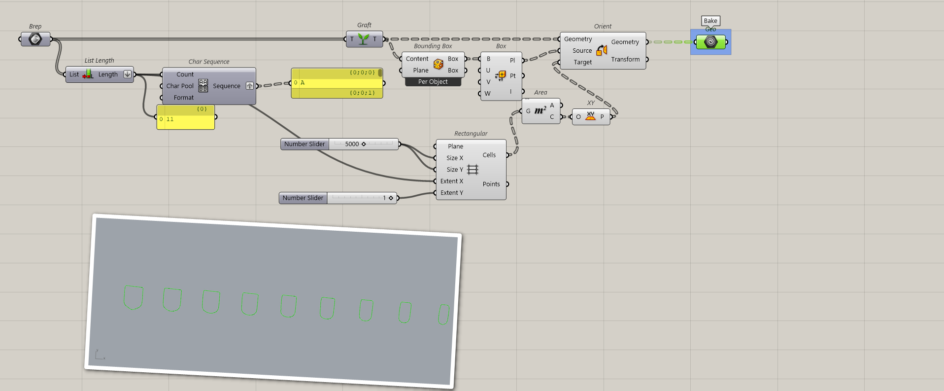

When i bake the surfaces , its not baking in the given position
when im baking the surfaces , its baking somewhere in the rhino workspace
could any one please check this once
block problem.gh (1.1 MB)
please help me with this

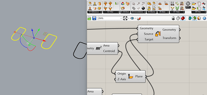

Do you need to have blocks?
What needs to be baked?
I selected your orient component, hit ‘insert’ with the keyboard and things appeared in the correct position?

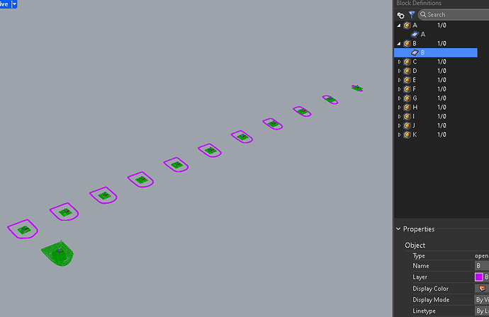

can you once bake with rectangles and see wether its coming inside of the rectangles or outside? , when i bake the oreint component it supposed to bake inside the rectangles not outside , for me its baking outside of the rectangles

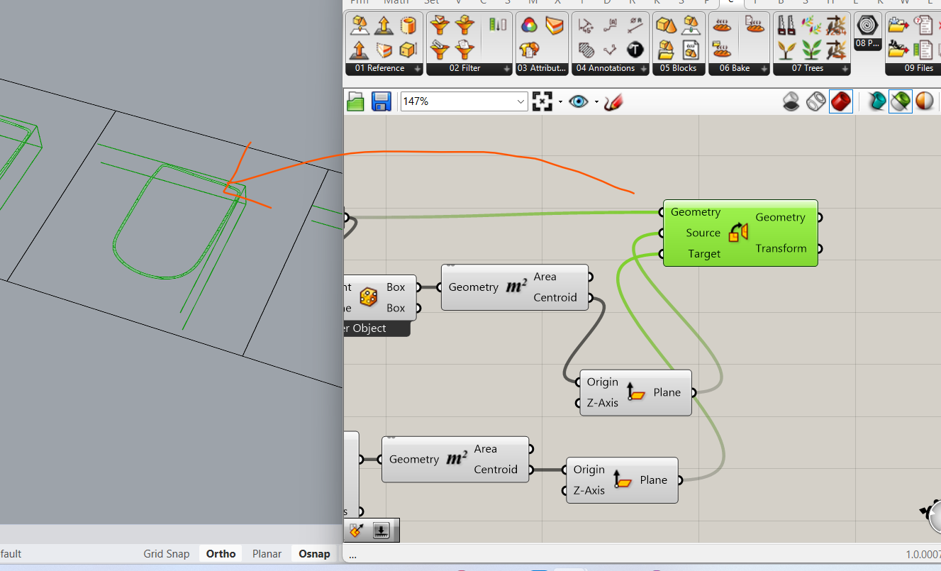

block problem_RevA.gh (1.1 MB)
thank you , rajeev
