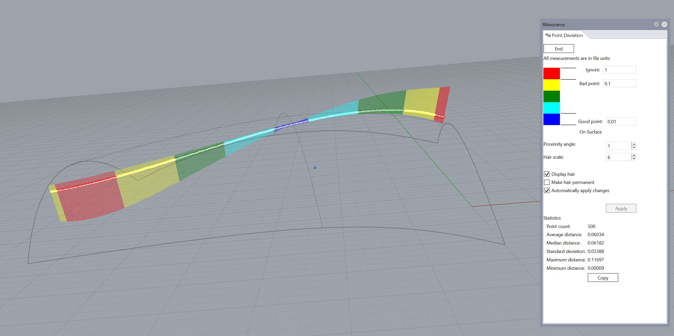

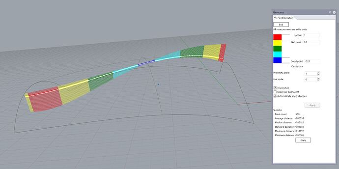

PointDeviation can be used for deviation of a curve from a curve, a curve from a surface, and a surface from a surface. It provides statistics and a graphic display, and updates as the curve or surface is modified. For me it is easy to use.
Enhancements I’d like to see are:
Selection of edges as “curve” for both objects to extract points from and objects to test,
Direct control over number of test points extracted from surfaces.
To use PointDeviation for deviation of a curve from a surface:
PointDeviation
Select the curve(s)
Enter
Select the surface
Enter
PointDeviationExample01.3dm (1.7 MB)
