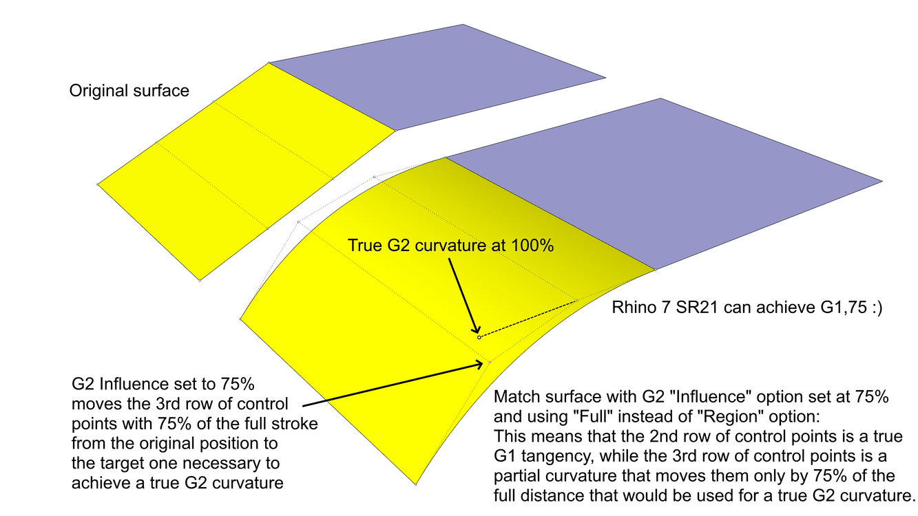

Example for a lacking functionality #5: Both, “Blend surface” and “Match surface” don’t have an influence option to control the amount of modification for the 3rd row of control points. With other words, that option should let the user set a variable rate for the curvature which is greater than G1 but lesser than G2. Currently, Rhino only supports either G1 or G2. The latter is way too aggressive in many cases and this is where the ability to set a custom influence of 50% for the 3rd row of control points would help to achieve something like a G1,5 instead. Also, the user must be able to apply “Match surface” to individual control points, too, meaning he or she could apply that only to a specific region of the surface while the remaining area(s) will not be affected. Example:
