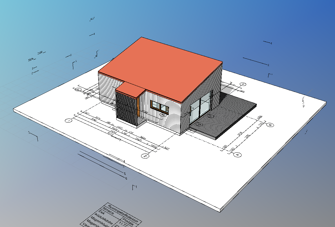

I’m having an issue with guides displaying incorrectly and popping in and out in elevation view, both in model and layout. Check out the video.
Additionally, they don’t seem to want to align the text in the correct direction or display at all in layout space.

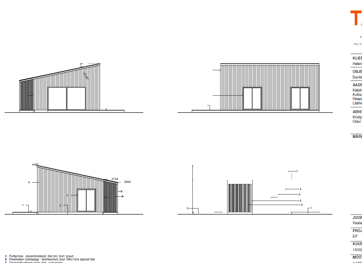

Hi, having similar issues, the guide lines are on roof plan view, but they are not visible on the floorplan and sideview. Im talking about the layout views. On the model space they are visible everywhere. Also there is a graphic error. I see the full side view (except the guid lines) nicely but when i print it to pdf in vectore mode - some elements are missing etc.
Hi @Kristjan we are currently working on this issue. I hope it is ready for the next Beta. Could you share your file as well? I’d like to take a look at the printing issue of missing elements. You can send it to visualarq@asuni.com or post it here.
I send it to visualarq@asuni.com

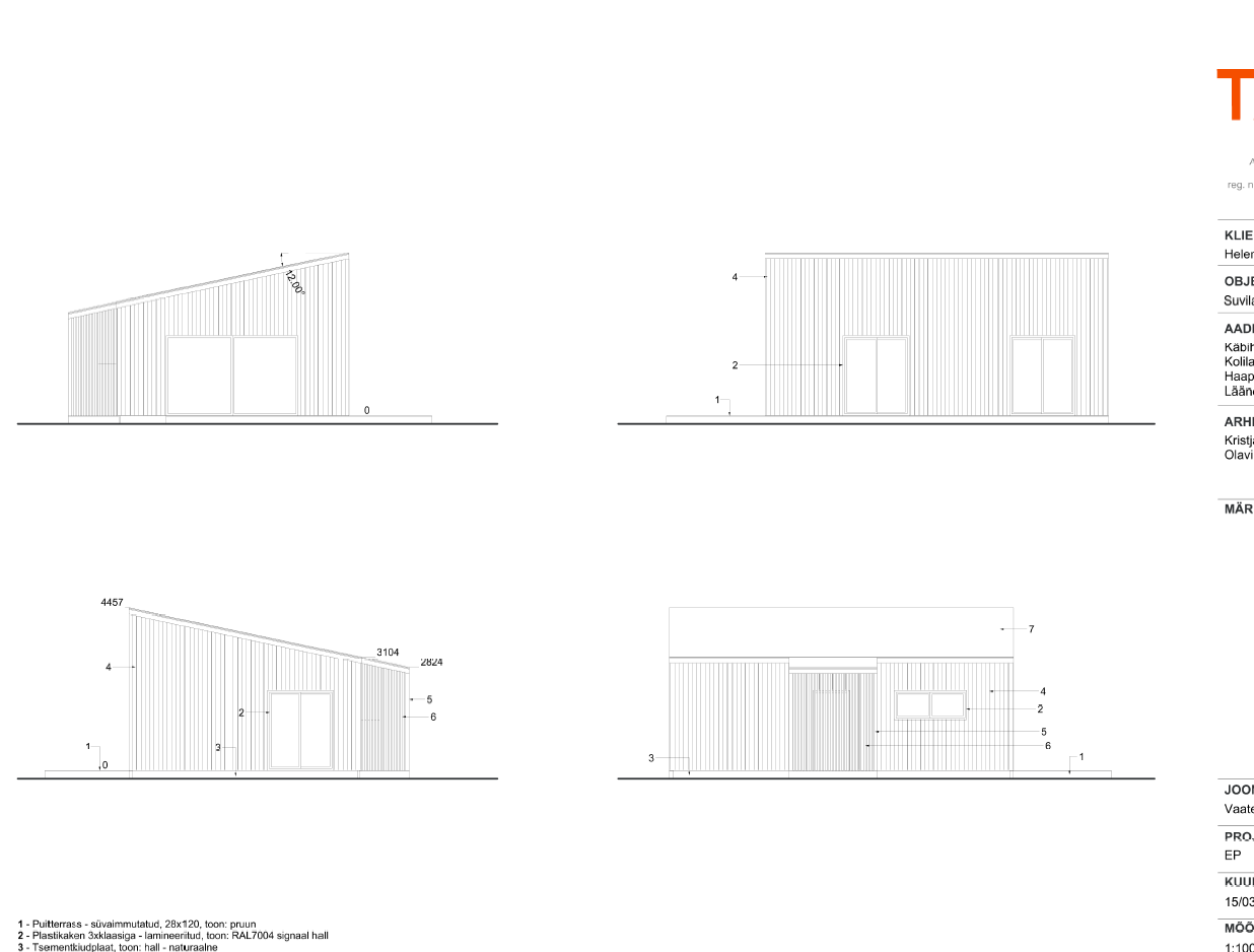

Hi @Kristjan I’ve tried to print your file in our latest internal Beta version, and it seems to work fine. No missing lines, apparently:
(We have fixed the issue of the Guides not being displayed).
Let’s see if it works for you too when we release the next Beta. I’ll notify you about this in this thread.
Thank you! Also I noticed that the leaders are showing correctly in layout but on the print they dont show the text or is it on wrong place.
Are these leaders created in the Model space or the page layout? do you have a simplified model to reproduce this issue?
These leaders are created in page layout trough detail view (entered into the model I guess that way). I hope that helps you.
I managed to reproduce the error of the text not being properly aligned in the print result, but not the case of the text missing.
