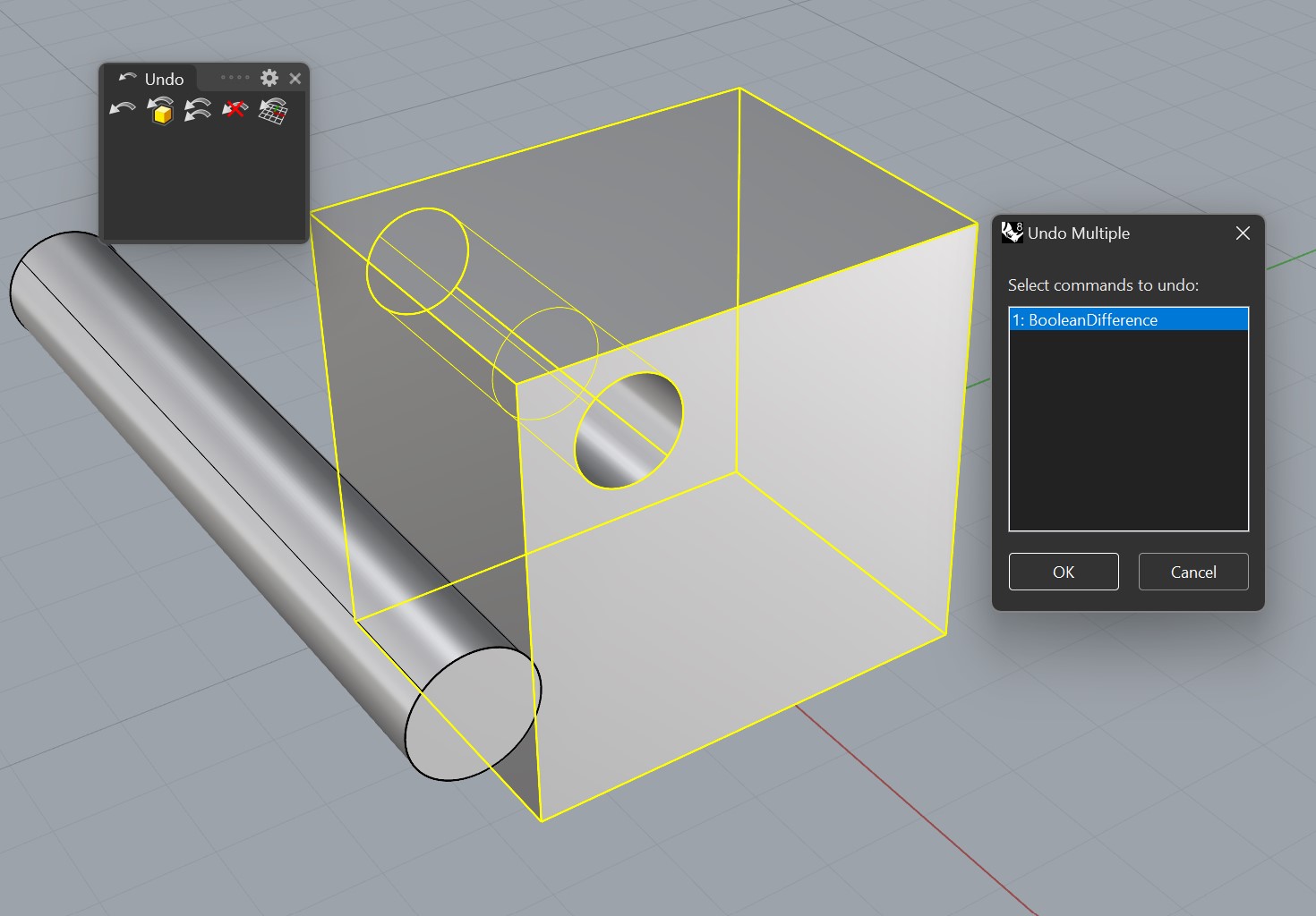

If you try to perform simple boolean operation (difference or union) then use undo selected, Rhino would delete the object. It works perfectly well in Rhino 7 tho. Same happens with new tools like PushPull or cutting with gumball…
Yes, I can reproduce this here with UndoSelected… still testing.
