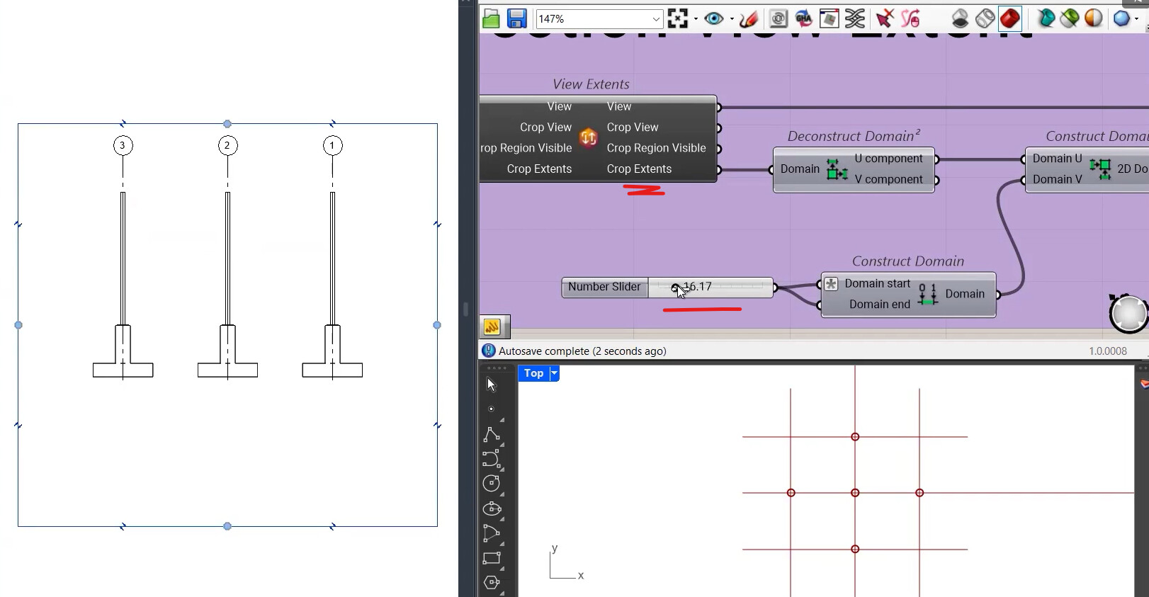

yes you can adjust the crop view using View Extents component
Hi Muhammad,
Your method will still require the user to manually use the slide to crop the view, I was hoping that the crop boundary would automatically contain the object in question, somehow using bounding box or another possible method.

I hope this is what you are looking for:)
That didn’t quite work sadly.
This seems to get a little closer but not perfect
Use View Crop Region Component
