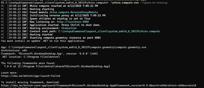

What happens if you open a powershell window and navigate to C:\inetpub\wwwroot\aspnet_client\system_web\4_0_30319\rhino.compute. Then enter the following:
.\rhino.compute.exe --spawn-on-startup
Essentially, I want to manually start the rhino.compute.exe process via the command line and see if there are any messages that show up.
PS, if you haven’t already done so, I would recommend adding an environment variable for getting more verbose logging information printed to the console output. You can read more on how to do this here.
Ha, I think that’s the smoking gun:

What happens if you type
dotnet --list-runtimes
into a powershell window. Do you see a version of .NET specifically for ASP (not desktop)? You need to have the ASP version of the NET runtime in order for compute to work. The next official release of Rhino (8.21 I think) should automatically install this for you, but that won’t be released for about another month. The hosting bundle in the bootstrap script should have been fine, but I’m curious what shows up when you run the command above.
Ok. But it still says that it won’t work if you try to run rhino.compute via the command line?
Yep same.
I could try installing the Runtime that the error message suggested?
That seems to have worked :crossed_fingers:
Wohoo. Thank you so much @AndyPayne
