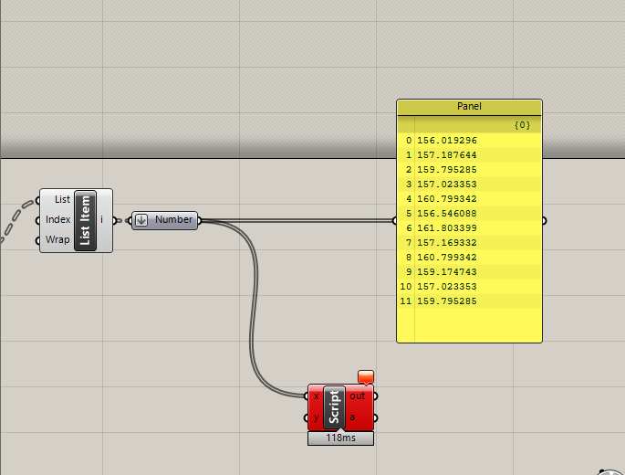

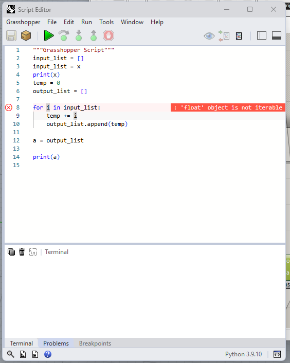

I am trying to use a list of numbers as an input in Python script inside of my Grasshopper program, but the input variable x only takes the first value and becomes a float.
How to fix it?

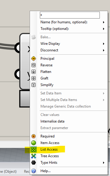

Just found the solution:
you have to right-click on the variable input and set it to “List Access”
