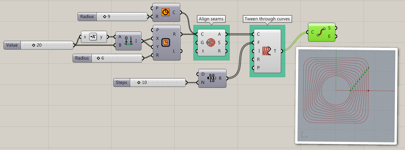

Does this work for Rhino V6? If I open in Rhino V5, it works fine. In V6, I get this:
Hmnn, that is strange. Maybe something changed in rhinocommon for curve closest point methods? The Align seams uses this method But clearly in your screenshot it isn’t going to the closest. I don’t have R6 at the moment to test but to be honest I haven’t paid much attention to R6 yet until things stop changing so much.

Or maybe it is tween component? In which case I will have to investigate a bit to see what R6 changed, lots of stuff going on in that one.
Certainly not a judgement, just an FYI, it looks like it may be in the tween through curves component. The same thing happens with that file as well. I am just starting to test out Pufferfish, nice job! I have a few ideas for how our shop might be able to use it in some of our terrain/contour/surface generation/refinement processes!
Thanks for pointing it out, it is hard to keep track of the little behind the scenes things Rhino 6 changes. Still trying to figure out a good time when to fully transfer to R6 :smiley:
It seems to me based on your screenshot that some method I am using was changed in R6 to readjust the seam back at the discontinuity (where fillet meets straight segment) which seems weird to me since in the tween component I don’t do anything with seam editing. Some pesky method is taking its own liberty and doing so, now to find which one.

Ok, I figured it out. I have a routine in my component that checks if the curve has any fillets, if the curve has fillets it explodes the curve, fits the fillets, and joins the curve back together.
In R5 Rhinocommon join curves doesn’t change the input curves seam location if no new segments are added to the curve. For some reason R6 Rhinocommon join curves resets the seam to be that point where fillet meets line segment.

This is fixed now in Pufferfish V2.2
