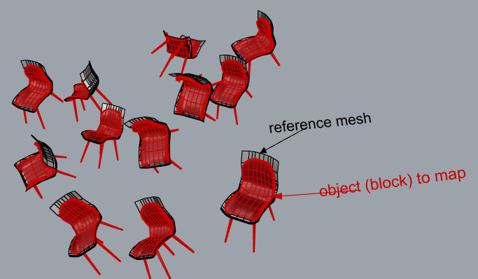

Hi Aaron,
A possible route to take is with this script I have laying around:
RemapFromMeshToMesh.rvb(3.2 KB)
It will map an object from one mesh to other meshes.
Your route could be to:
1: Create block from a copy of a particular podium.
2: Mesh that particular podium
3: Mesh all other podia.
4: (assuming a podium converts in more than one mesh) Either join all meshes per podium or single out a single mesh part per podium.
5: Drag Drop the script over Rhino and follow the steps
(there is even an auto-detect mode that attempts to find all meshes with apparent equal topology for you)
See example here:
MapBlockToMeshes.3dm(360.2 KB)
HTH
-Willem

Good morning @Willem,
Forgive me, but this looks like a very promising script. I am having trouble using it though.
Here is what I did:
I got the prompt "Select Objects to Map. I selected one of the grey chairs/ Enter.
I was prompted to “Select a Reference Mesh”. I picked the red chair./ Enter.
I was then prompted to “Select Meshes to Map”. I’m not sure what this is for. I pressed Esc for autodetect.
I was then asked whether I want to “Auto detect mesh instances”./ Yes.
At this point I got a Microsoft VBScript runtime error.
Very excited to use it, but tangled up in the options: (
Thank you.
Cosmas
Hi Cosmas,
I guess the wording is somewhat ambiguous.
I adjusted the script to make the instructions a little more descriptive:
RemapFromMeshToMesh.rvb (3.3 KB)
“Select Objects to Orient on multiple Meshes”
“Select Reference Mesh to derive orientation from”
“Select Meshes to Orient on (Esc for autodetect)”
So you picked the objects in the wrong order.
1: select the object(s) to orient/distribute on the meshes.
2: select the mesh that the above object(s) are oriented on.
this is the reference mesh to use for orienting the picked objects to all other meshes
3: pick the meshes equal to the mesh above that the objects need to be distributed on.
autodetect will try to find all meshes with equal Vertices, Faces and Area and distibute the
objects on them.
Let me know if it is unclear or does not work for you.
-Willem

The script works great --and is really awesome. Very promising. Thank you very much.
Cosmas
