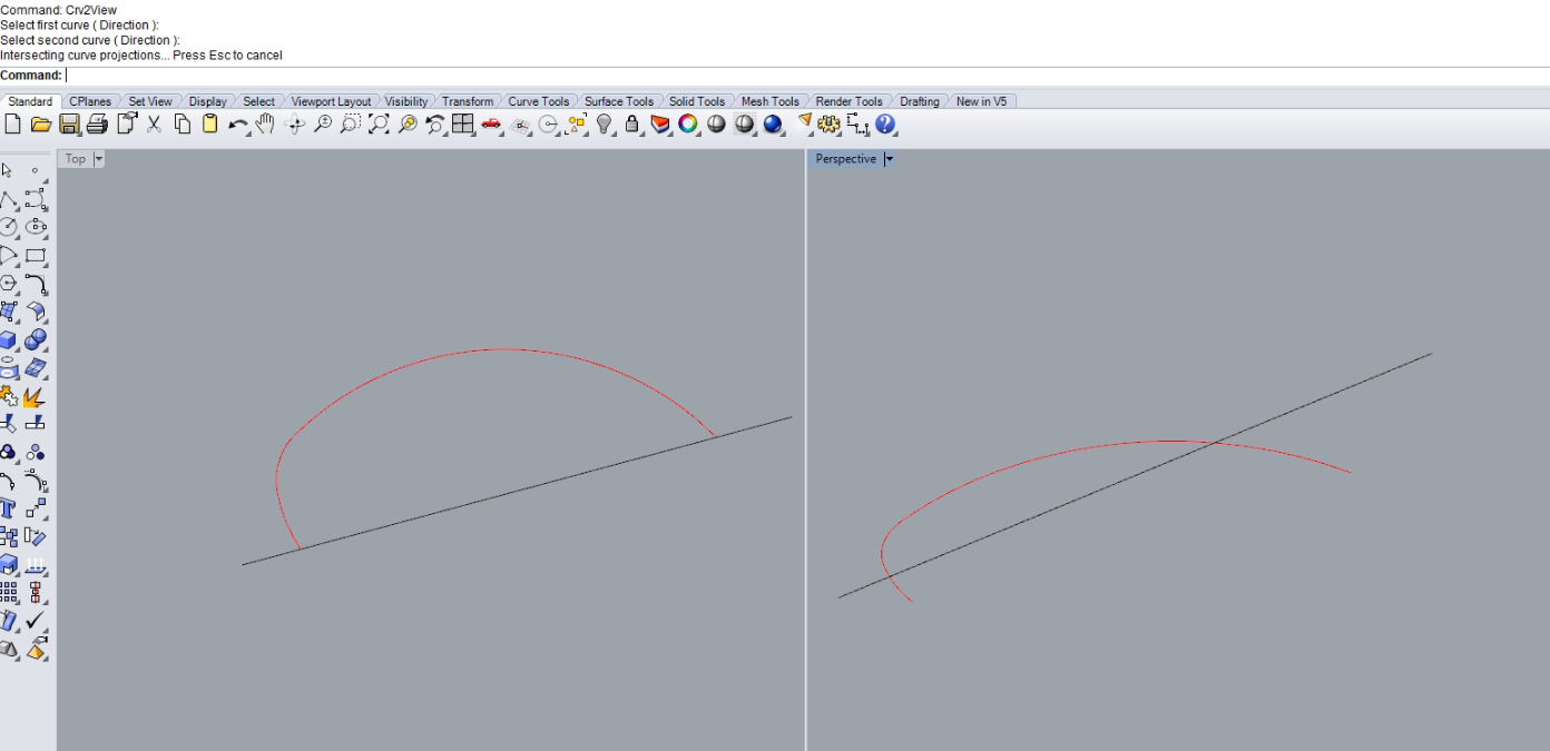

you can use the _Crv2View command, for example:
it will make an extrusion of each curve you select on each view and then return the intersection between them.
It is not working, or it is supposed to cost a large amount of time?

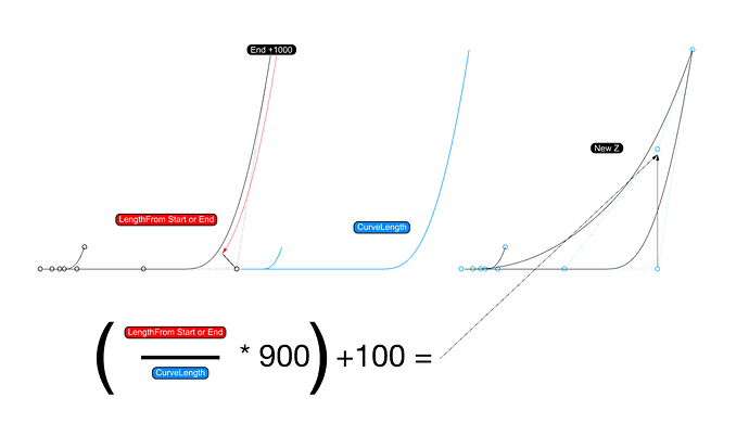

I just know the start and end point Z value
I want the interval points automatically rise to certain value.
For example, my start is +100 and end is +1000, and the interval point Z value should be equal to
[(Length from start) / (Length of Curve) * 900 ] +100
Is this the idea ?

From what I understood, you are attempting to elevate a set of points in Z using Ratio’s that are mainly calculated using distances along the original path (from start to t ) and the total length of that path
Is that the intent ?
