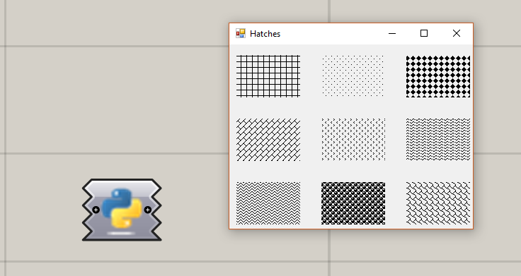

Hi @Antonio_Cersosimo
This is the second example posted on the website you linked, working in GhPython.
on-paint.gh (3.4 KB)
Here attached is all the examples working in GHPython(of the linked website). I was able to change the color in the OnPaint(), I was missing the refresh() method in the If Statement.OnPaint_2.gh (12.1 KB)
