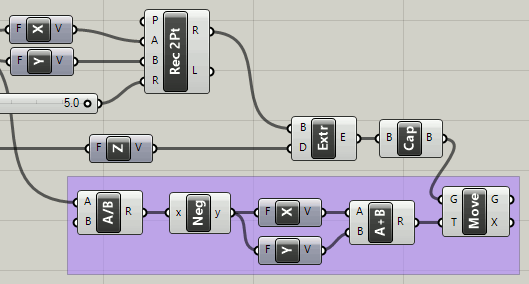

You’re getting two objects because you’re supplying two vectors. Add them together instead (purple group).
movement_2019Nov19a.gh (12.4 KB)
