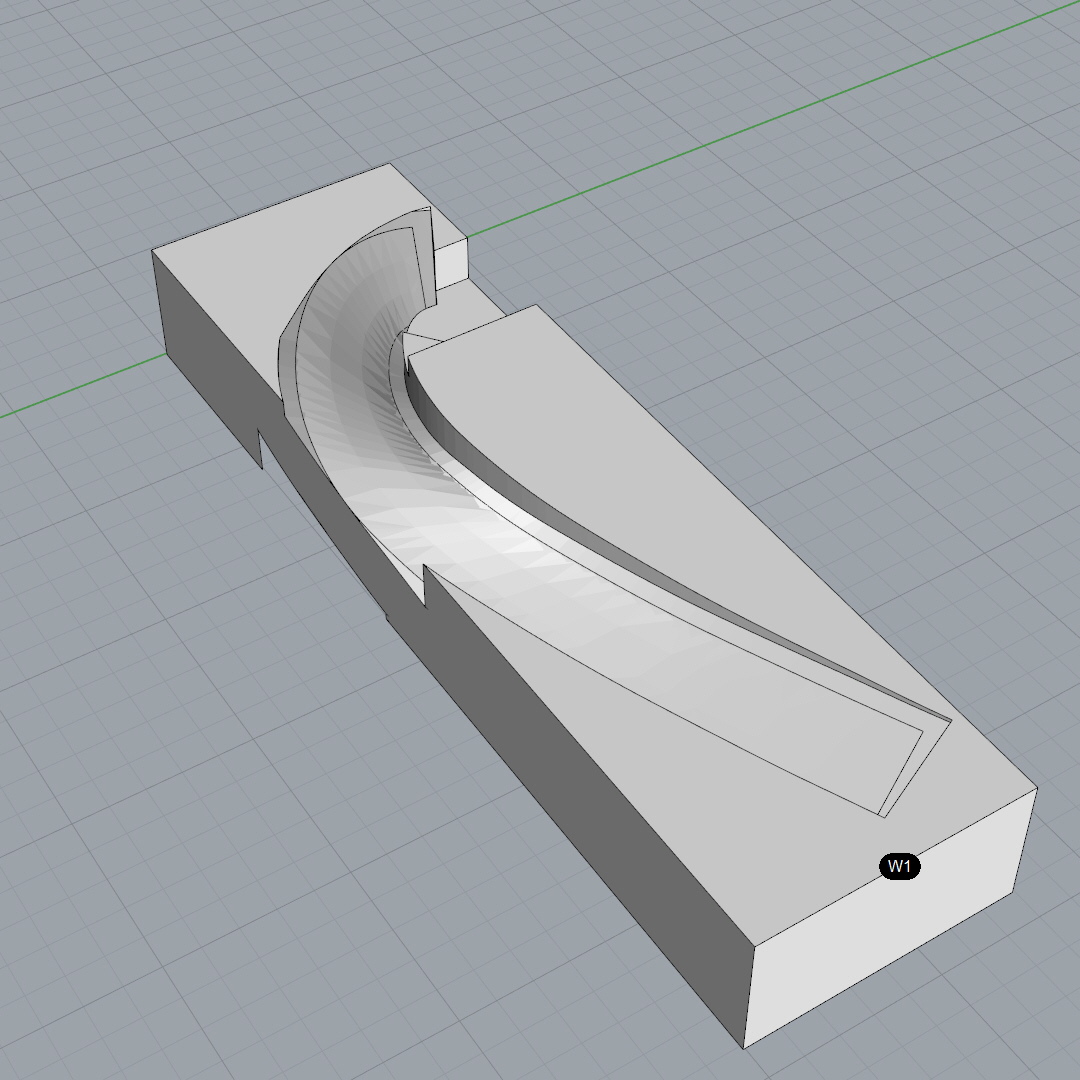

Hey everybody. Looking for some advice to eliminate surface faceting for a machined parts. I initially thought this was just an issue w/ the way rhino draws things on screen in shaded view, but i’m finding that this type of faceting actually translates through to machining. How can I avoid this in my build process? The basis for the model is a single sweep, which is then trimmed, placed into a bounding box and the surface offset 1/32" in all directions for CNC routing. The faceting is present in the initial sweep.
Thanks for any assistance.
srfFacets.3dm (788.9 KB)
@asbeastos,
the surface is a bit wavy judjing the edges :wink: …and has multiple knots. You might clean it up somewhat using _RemoveMultiknot and _FitSrf. Below surface was done using a tolerance value of 3 and i´ve slightly point edited it to reduce the deviation from its source. How much deviation is allowed ?
srfFitted.3dm (37.8 KB)
btw. compare with _Emap and set Max edge length to 0.1 in the dialog…
c.

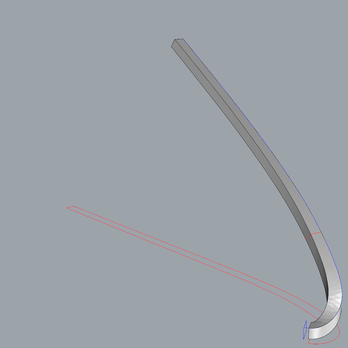

Yes, this one is quite wavy. It is a handrail for a staircase, so I’m bound to the Plan view curve, and a few other rules(mentioned later), but can deviate as necessary in elevation in order to get better surface quality.
Here is the base model that this blank was generated from(the red planar curve around the rail is the cut plane for the part in the previous model).
The bottom surface must always be parallel to the ground plane perpendicular to the sweep curve, and the sides must remain vertical on the plumb line. sweep and cross section curves are in blue. I swept this 1/2" wider than necessary, then wirecut w/ the plan curve in order to guarantee that the sides remain plumb. The plumb sides and level bottom are important for machining processes later on during production.
Any tips on producing a cleaner sweep from the get-go?
Thanks a bunch.full rail.3dm (502.9 KB)
Hm, you could try to build a smoother inside rail (dark green in my file) and match it to the magenta arrow. I got it from an edge of the surface build by Sweep1 with Roadlike=Top. I guess the flattening effect is fostered by the linear segment at the end of your current rail. (which runs outside) Running outside does truncate the surface at the inside.
If you have the slightly larger surface, it might be trimmed from top view so it still stays within the plan curves but only deviates in elevation. To get the plumb sides, i would just extrude them vertically then build the lower surface using sweep2.
full rail.3dm (436.2 KB)
c.

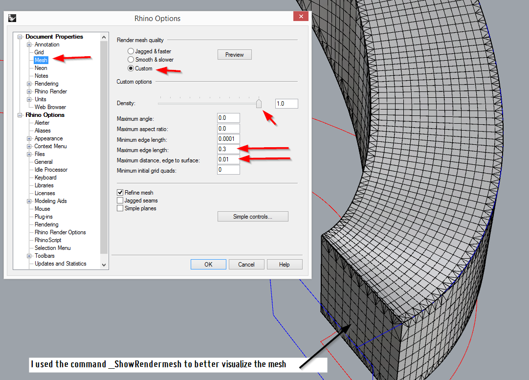

Hi Adam,
If this faceting shows up in machineing, that mean the machine is using the rendermesh to machine correct?
Apart from tweaking the geometry, you will need to adjust meshing settings, yours is currently at jagged&faster.
I took a stab at the last file and came up with this:
HTH
-Willem
And you can make custom meshes for individual parts. So, if you have a complicated design/drawing/thing, you can choose which parts look good for the sake of looks, and still have speed.
Or, you can work with coarse objects that still work fast on your computer, and then later export much finer meshes for machining, fem, 3D printing.I

Are you sure about that. As the link below shows it seems RhinoCam does use the rendermesh. But it’s not my field of expertise so I might be wrong.
I think the best way to find out is to set an extremely low quality faceted rendermesh and see how the toolpaths come out.
-Willem
