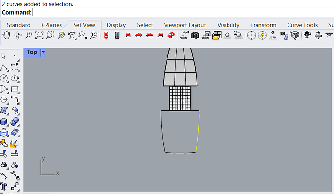

Hey @akche001 I had a go at the second curve and it says i am unable to join these curves. Any idea how I can interrogate why?

It can cause due to duplicate segments in same place. Explode it and use command SelDup to select duplicate segments and delete it. Then try joining again.
It says no duplicates can be found.
Allroofs2.3dm (81.2 KB)
As I suspected, there are two segments at many places. You need to explode the curves until all segments are exploded. Then delete duplicates manually.

The problem is at place where it is not joining. You need to zoom close at joining point and see where there are 2 curves. explode the problematic curve and delete duplicated segment. And try joining again.
