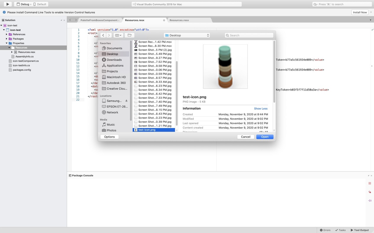

Just to make it a little clearer for other people I’ve:
  1. placed using the Mac [File] Finder an 24x24 pixel png image icon (called named_icon.png) in a new folder called “resources” in the folder called “Properties”
  2. added the icon to the project directory by drag and dropping it on the “Properties > resources” folder in Visual Studio
  3. right click on the added icon file and set Build Action > Embedded Resource
  4. added resource file to the project (by right clicking on the “resources” folder in Visual Studio) selecting Add > New File… (in the pop-up that appears) Misc > Resource File
  5. the file resource.resx opens and the xml code is modified to include <data name=“icon” […etc…] from your file just above the final line
  6. left the PublicKeyToken alone (seems to work like that)
  7. added this line to my .cs code > return Properties.resources.Resources.named_icon;
(next time I’ll name my folder icon_folder to be less confusing)

I just went through this successfully again and took screen shots
Don’t forget to save the resx file after you have edited it
I hope this is useful for someone
