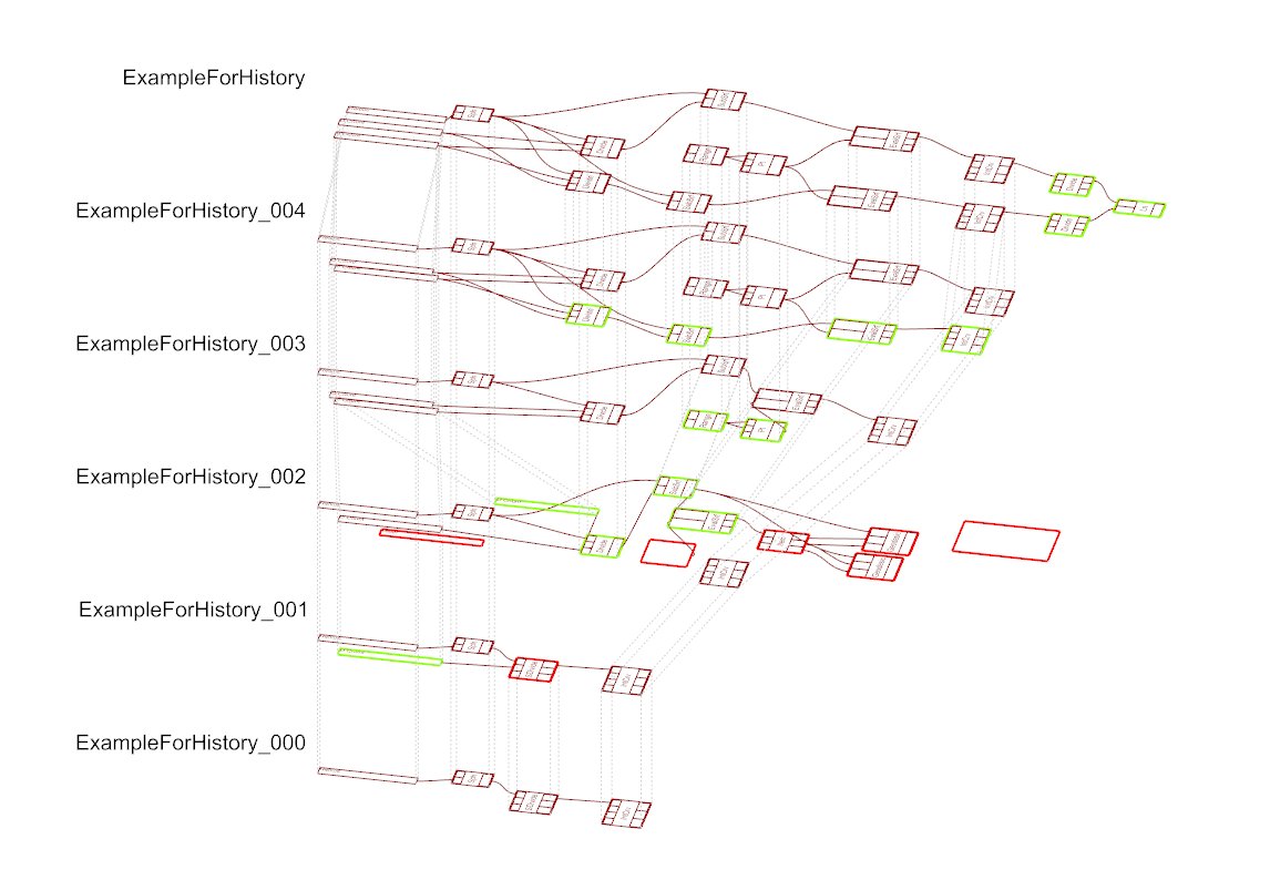

You might also be interested in another experiment of mine - doing visual diffing with Metahopper like so:
I never wrapped this up into a proper tool but the basic principle relies on the fact that metahopper’s “DocumentInfo” component can read external files as well as the active document - from that you can get all components, params, objects, wires, guids, etc, and do just about whatever you want with that information.
