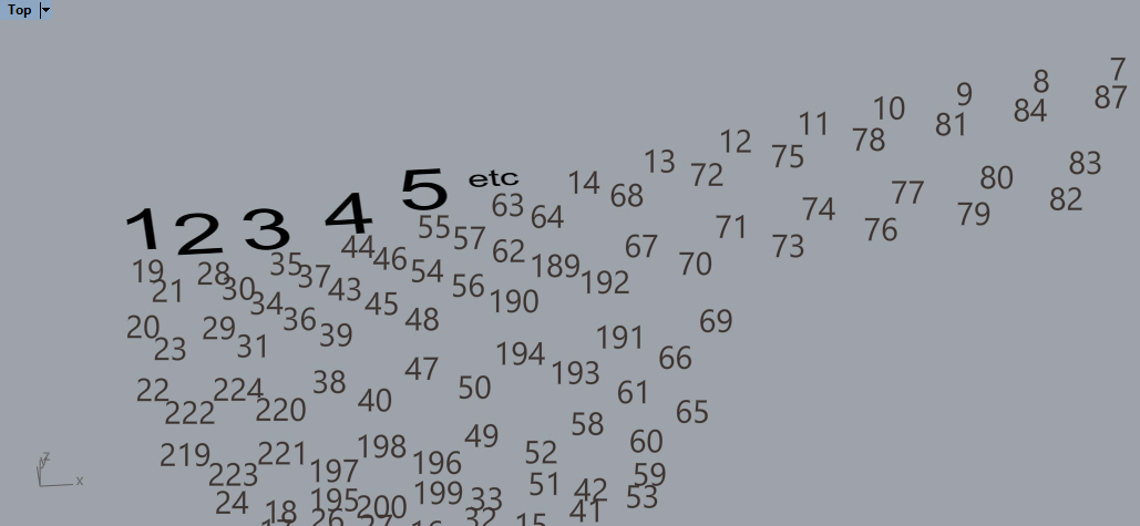

the point is make coincident the 3d surface with unrolled surface.to get the numeration.

that’s the problem does not match I had to unroll by script and reference it in grasshopper, the script gave me that order so I want to compare the object by area to matchching the object and numerate sequencely starting in 0 that would the closest element to the reference point.
The Sequentially Sort Points by Distance command could reorder decently my elementes with a point like reference but I would make it with native commands if would be possible.

BTW I just want the 3d surface and unroll surfaces have the same number, next as you can see the order in 3D surfaces is a random value I would like to see a little order to organize the pieces after cut
