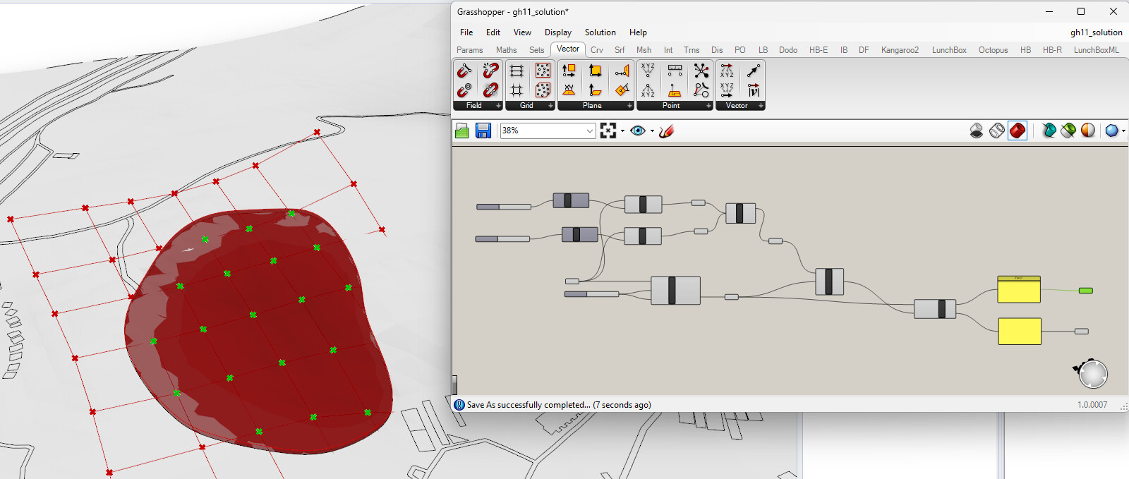

I found the solution guys, I wanna share it with you, maybe you need help in the future.
gh11_solution.gh (8.3 KB)
You didn’t understand what I posted. ![]()
Your geometry is still not internalized and you are still using Lunchbox Grid Structure when it’s not necessary. If you must use Lunchbox, you could internalize its output for those who don’t have (and don’t want) the plugin. I see you used Dispatch instead of Cull Pattern…
