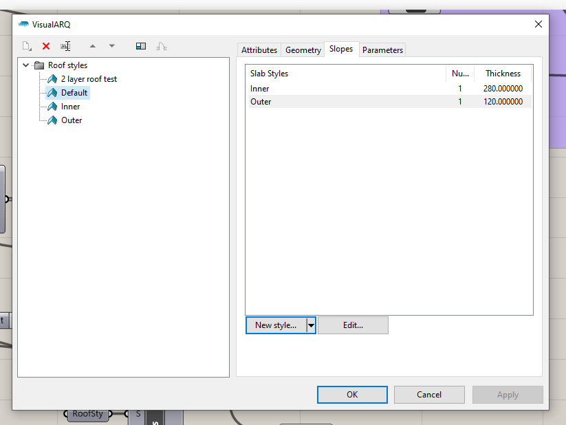

Ok so trying to have a house with an outer roof with an overhang past the outer walls and an inner roof within the outer walls. So, im trying to create two different roof types : inner and outer as you see in fig. 1.
The problem is it seems im not able to have more than 1 roof style as ALL the styles change when i change one of them.
All roof styles insist on using the same slab styles and i cant remove a slab style from a roof style. Its hard to talk about…i hope you understand.
I think im misunderstanding something … i hope so at least

Hi @Jens_Jacob_Melhus_Ju,
What you are seeing in that list are all the slab styles you have got in the file. The one used by the roof style is the one highlighted.
For example, in this case the “Default” roof style is using the “Standard 3” slab style, the other 3 are just listed in case you want to change the slab style for that roof style.
Thank you Alfonso!
I get it then. Its very obvious when you know it.
Great help.
