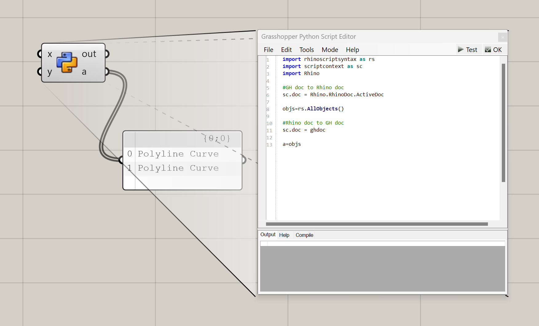

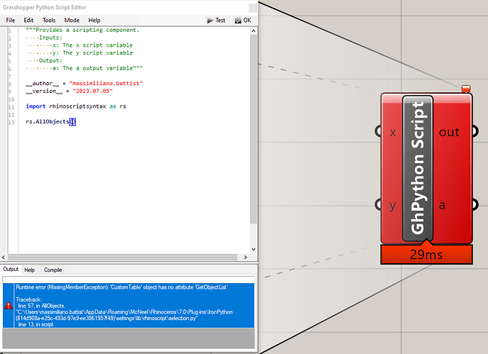

Probably just another epic fail but it’s weird and don’t know why it happens. Can you please help me?I’m using Rhino 7
Version 7 SR30
(7.30.23163.13001, 2023-06-12)
Commerciale

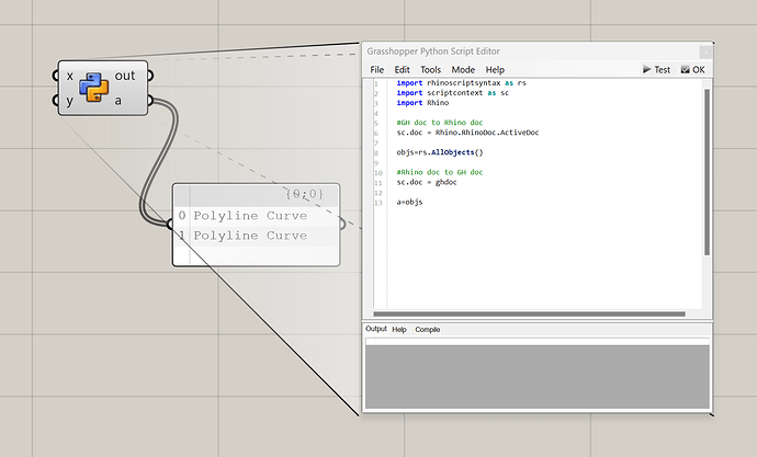

If you are looking to get all the objects in the Rhino document, you need to switch to the Rhino document space, not the Grasshopper document space.
thank you. It was easy at the end. I have to study ![]()
Grasshopper in Rhino 8 will make this easier, there are components to get objects, layers, etc, directly from the Rhino document.
