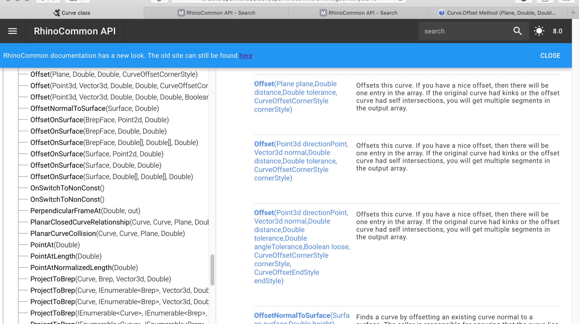

I checked one (fictional) workflow - test scenario.
Let s say I search for
curve offset
or
curve NormalizedLengthParameter(s)
overloads
searchbox: offset
3rd hit ist Curve.Offset which is overloaded…
click on the result
I still get all 3 overloads in one main window
but the title Offset method is missing for the 2nd and 3rd overload…
the tree to the left is not scrolling / showing the correct possition
by clicking on the left tree
Curve → Method → Offset
I only get one Method-Description Overload / definition in the main window.
while the best overview of al Overloads is in the main
Curve → Methods … overview / main window…
( that can only be reached with a lot of scrolling)
I still think that getting an overview on overloaded Definitions should be easier.
the screenshot shows the overview on all “offset” Methods.
I have to scroll twice - the main window and the tree.
that s the corresponding view from the old docs - 2 mouse clicks
scrolling
I like that the left tree is scrolling to the correct branch, even if navigation is not via tree. - that s great.
but scrolling does not work as expected if navigation is coming from the search-results.
kind regards -tom

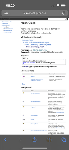

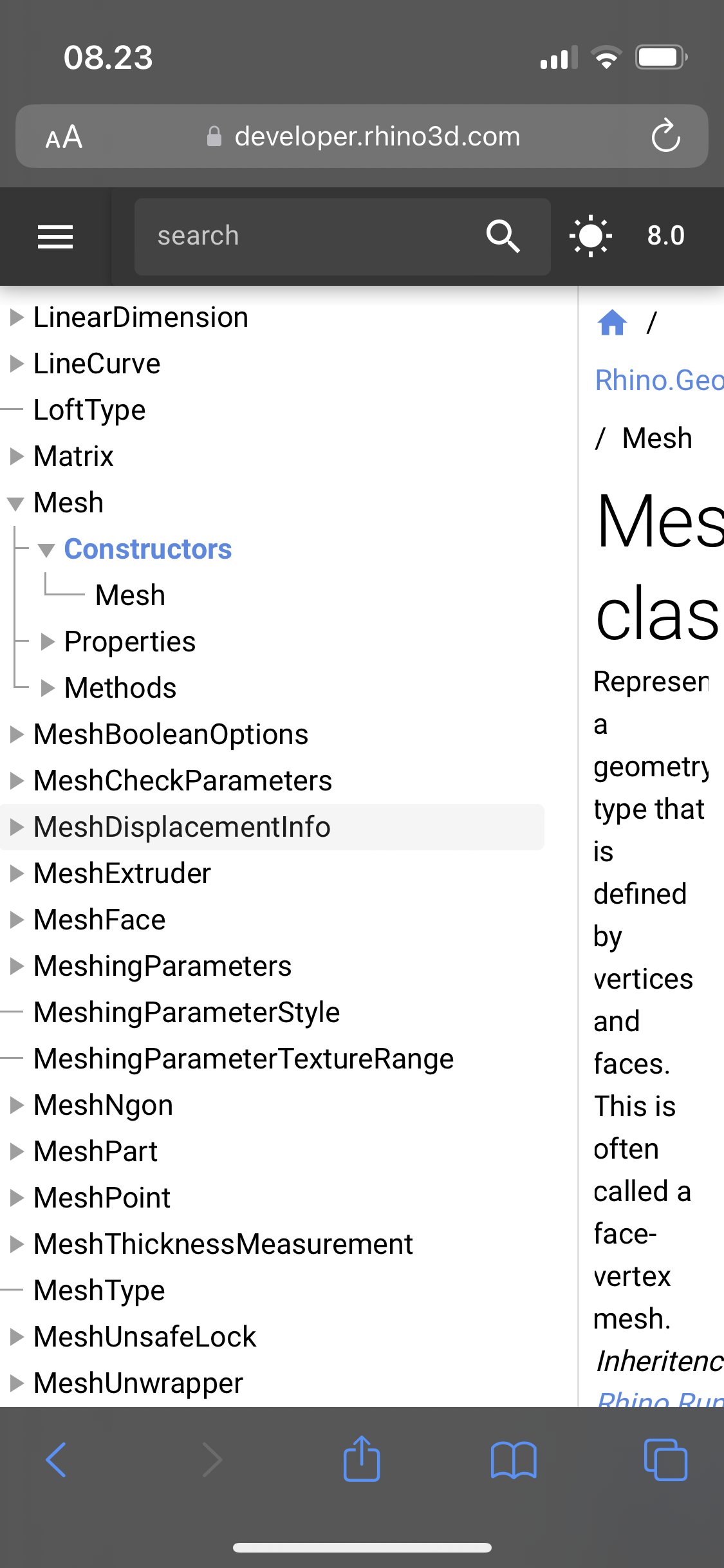

I apologise if this has already been covered above (did a quick search without results), but the mobile experience is also worse with the new docs. At least on iOS Safari on my iPhone 13 mini. And especially in portrait mode where the right side information window all but disappears:
Landscape isn’t much better, but one can at least read it:
The old docs behave like a “normal” website (i.e. one can pinch zoom in and out to view things). Where the new one has these different windows one can just pan around in, sorta :thinking:
Tapping this button toggles the navigation tree so you can see the content on the right side.
Ahhh, totally missed that, thanks. You still can’t pinch zoom out though it seems, so it feels like panning around a “restricted box”.
That’s just how mobile responsive websites work. Try Wikipedia, the free encyclopedia or any other modern website on your phone for example.

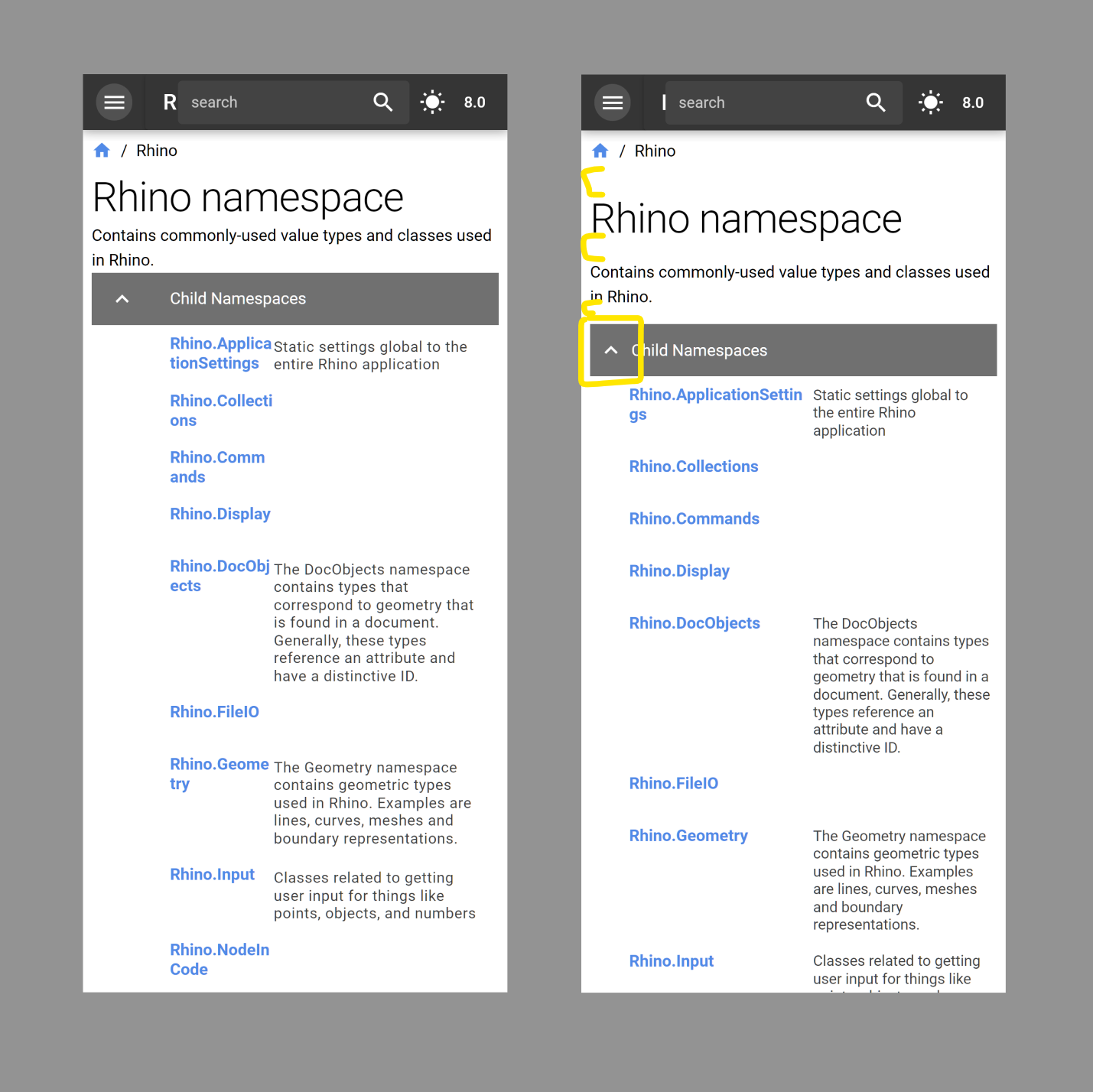

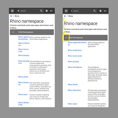

If I may give some suggestions how to improve the CSS on mobile. Before on the left, after on the right.
  • Decrease the left/right padding of .q-item to 0px
  • Actually make the left and right column (.row>col-8) both 50% width. It makes the labels much more readable, while the small text on the right is still fine
  • Increase the gap between the 2 columns
  • Make the label and text appear more like they are on the same baseline ( .q-item__label+.q-item__label { margin-top: 1px;}
  • Please remove the letter-spacing from the text on the right ( .text-caption { letter-spacing: 0;}. There is in 99% of cases no point in increase letter-spacing and it actually makes takes harder to read
  • The text on the right needs word-break: break-word, so that long strings like URLs don’t run off at the right border. I also think that all URLs should actually be clickable for it to make sense :wink:
  • Increase the spacing at the very top between the breadcrumb and title, title and text and text and table
  • Give the toggle title a lot less indentation
I would also try to fix the search field at the top so that only the search icon is visible and when you press it, the search field opens up. Something that you see with most search fields on a mobile header. It’s just a few lines of CSS and Javascript.
I hope this helps. I have worked as a web designer and in recent years as a full-time UX designer for many large companies.
Thank you @seltzdesign , all great suggestions. I filed it here and hopefully will get to it in the near future.

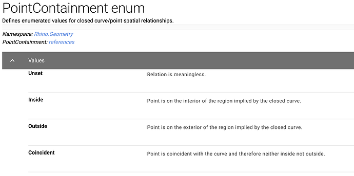

enum needs some care to (always) show numeric values.
example PointContainment
old
old documentation shows the corresponding numbers
new
new documentation does not
https://developer.rhino3d.com/api/rhinocommon/rhino.geometry.pointcontainment
and the table rows might have less height ?
