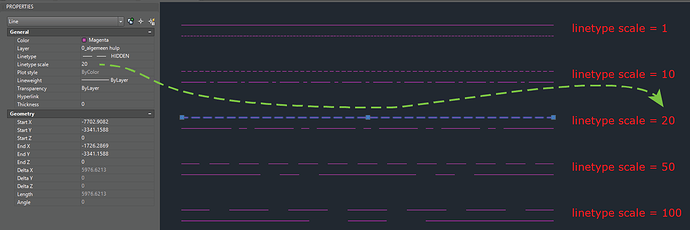

How do you handle linetypescale when drafiting? In Autocad I am able to set a linetypescale for each individual curve if needed (with the same linetype).
Do you create a whole bunch of linetypes wtih the same appearance but different scales?
Yes, indeed. I do it like this. But I agree that in AutoCAD that is more convenient. Can someone from McNeel please answer that question??

In my case I draft a floorplan for example and some details in modelspace. The floorplan contains curves with the hidden linetype with a scale of 100 and 200 for example. The details contain curves with the same hidden linetype and scales of 2 and 10.
And ofcourse I want a layout of the floorplan 1:100 and a layout with the details 1:5. I usually draft in WYSIWYG way.
So I need the same hidden linetype in multiple scales. The same goes for centerlines and other linetypes.

How should I work if I want that my linetype (dashed or so) looks exactly the same in the Top View and in the Layout, independent from the scale of the detail?
Wouldn’t it also be very useful if you could change the linetype scale of a single line/curve also in the properties - exactly like you are able to change print width and color?
Exactly, something like linetype model/layout scaling would be very handy I guess. I think this wish was asked some time ago…
This is the way I work in AutoCAD with linetypescales and the settings for MSLTSCALE and PSLTSCALE.
The picture shows the setting for the linetypescale in the properties panel.
The pdf is at scale 1:50
