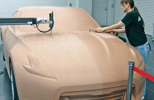

Using patches and and all other kinds of tricks and tools to get to the shape one is after is a must. Be dirty in the moddeling so your vision controls the shape, instead of letting the workflow control it.
And when a car goes to production the surfaces will most likely be remodelled by the the engineers, so G-perfect isn’t that important. Too many cars have been design with focus on the surface continuity instead of the overall expression IMHO. Also most cardesigns goes from 3D to clay to handtuning of the clay, to scanning and back to 3D. Because you can’t beat the touch of the hand and nobody cares if the G-continuity is perfect if the hand doesn’t like the shape :smile:

Hmm using those tools means you don’t really have a grip on the shape, you’re just saying “here are some edges make it smooth,” you don’t know what you want at all.
Most of these situations can be avoided if you take some advice from the other Jim. Remember how he was always yammering on about FilletSrf being better than FilletEdge? Well he’s right, and when you start working on complex forms with that in mind instead of trying to make everything a solid to round the edges off of, the nasty 5-sized corners largely disappear, they turn into fillets on top of fillets(substitute “blend” if you want to talk about “class A,” thanks for the picture no one is talking about cars here,)and you have much better control.
Yep, sometimes you just have to hack something out no matter how, but if you don’t understand the tool well enough to know when it can be avoided, you’re not really going to realize your “vision,” and I don’t think most Rhino surfacing users have the luxury of passing off junk to the engineers to redo.
