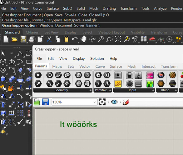

In https://docs.mcneel.com/rhino/8mac/help/en-us/commands/grasshopper.htm?Highlight=grasshopper it is said that the filename of the grasshopper file may include spaces, and in this case it is necessary to enclose it within double quotes.
I works well when it is used in the command line inside Rhino, but what I need is to run the command at Rhino startup. So, I use command line arguments like it is explained in: https://developer.rhino3d.com/guides/cpp/running-rhino-from-command-line/
This is my command-line (Batch *.bat file):
Rhino.exe /nosplash /runscript="-Grasshopper D O “C:\Test Open\Test.gh” W H -MaxViewport“
It does not work on my Rhino 8 (Windows11). The space between “Test” and “Open” breaks the script.
So, the problem is: when typed in as command inside Rhino, it works perfectly and the path may include spaces (enclosing it with double quotes), but if passed as a script to run at statup, through the command line from the operating system, the double quotes break the script and it does not work.
Does anyone know how to solve this issue?
Thanks a lot!

It should be:
Rhino.exe /nosplash /runscript="-Grasshopper D O ""C:\Test Open\Test.gh"" W H -MaxViewport"
Note the double double-quotes.
I have a file space is real.gh
I have a shortcut link with /runscript, the path to the GH file is in the double double-quotes
Using the shortcut gives
Note in the last screenshot that the path to the file is also in double-quotes. That is because in the shortcut I enclosed it in double double-quotes.
Wow, double-double quotes: quadruple quotes
I should have tried it!
Anyway, @nathanletwory , you solved it. THANKS!!!
Finally, do you know how to finish the command? In the Rhino command line, it remains the -Grasshopper command active.
It is easily finished, pressing “Enter”. But I would like to achieve it through the script used at the startup.

Add _Enter at the end of the script you run, before the final double-quote
