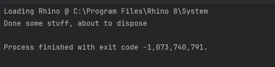

Hey, I wonder if I could get some clarity on the threading requirements for using Rhino.Inside to create and dispose headless documents.
I’m seeing some weird behaviour where the disposal of the RhinoDoc is causing my application to crash without a managed (.NET) exception for me to handle…
Here’s a minimal code sample that reproduces my issue. Regardless of the 3dm file you import, will crash on the line that disposes the open document, and the line “Success” will never print.

I thought that perhaps there’s some requirement to create and dispose the document on the same thread. So I did try wrapping all the code after the new RhinoCore in a Task.Run to keep everything on a worker thread. But same result…
I also thought, well maybe it’s not safe to use worker threads to create/dispose documents… But interestingly, if you import a non .3dm file (like a .obj, or .stl file) then the dispose works reliably.
I’ve also tried using RhinoDoc.OpenHeadless instead of RhinoDoc.CreateHeadless + RhinoDoc.Import …
Same results.
So what gives?
Ultimately my goal is to be able to open and close a headless document, while performing some kind of await async action while it’s open…
Here’s my full .NET solution. I’m using Rhino.Inside 8.0.7-beta, and Rhino 8.22.25210.13001 (2025-07-29)
RhinoInsideCrash.zip (24.5 KB)
Steps to reproduce.
  1. Open solution
  2. restore
  3. build
  4. run
  5. observe non-zero exit code in console, and no “success” message gets printed…
Interestingly, the same code appears to run successfully with with rhino inside 7.0.0
But not 8.0.x or 9.0.x versions…

Hi @Jedd_Morgan,
I can repeat the exception, and I’ve logged the issue:

Unfortunately, this issue has gotten a lot worse with the latest 8.25 RC (8.25.25287.14001, 2025-10-14)
I’m now seeing a new behaviour trying to OpenHeadless from a .NET worker thread.
Most of the time I receive.
Fatal error.
System.AccessViolationException: Attempted to read or write protected memory. This is often an indication that other memory is corrupt.
Repeat 2 times:
   at UnsafeNativeMethods.CRhinoDoc_OpenHeadless(System.String, IntPtr)
   at Rhino.RhinoDoc.OpenHeadless(System.String)
Process finished with exit code -1,073,741,819.
Here’s some new sample code to reproduce the problem

So far, any Rhino8 3dm file can repro the issue.
Hi @Jedd_Morgan,
This is still an open issue.
– Dale
RH-89095 is fixed in Rhino 8 Service Release 29
