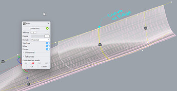

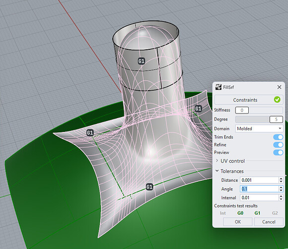

I see what you mean. By default, FillSrf tries to meet the document absolute tolerance for the positional constraints and the document angle tolerance for the normal constraints. Your document has quite strict tolerances that increase the refinements of FillSrf unnecessarily, ultimately not giving a result with default settings. I’m not saying that having strict tolerances is bad, but in this case it does not give the result you’re looking for.
If an angle tolerance of 0.5 or 1 degree is used, FillSrf produces a similar result as xnurbs. Even 0.2 degrees works, but 0.1 does not.

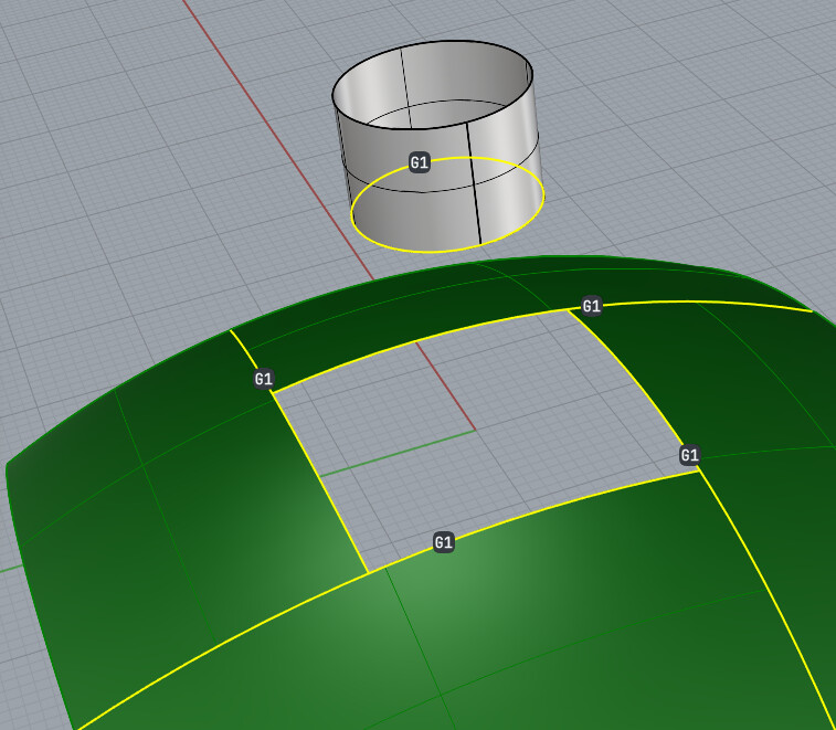

Trimming fails in this combination:
CP_2025-05-14_fillSrf_trim.3dm (909.5 KB)
Correct, trimming is only supported in cases where a single, closed trim-loop is present, made from G0/G1/G2 border constraints. Having surface edges as internal constraints with continuity is an existing feature request.
Right now, it should be possible to trim the result obtained with the constraint curves you selected in a next step after FillSrf. Looks like it is necessary to duplicate edges, trim edges to form a closed curve & join prior to using these edges as trim cutters though.

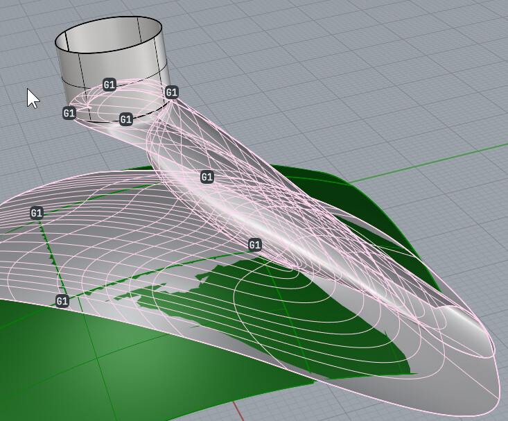

Before I knew about single, I have split the edge of the grey cylindrical shape to 4 pieces:
With this perhaps stupid input _FillSrf freaks out:

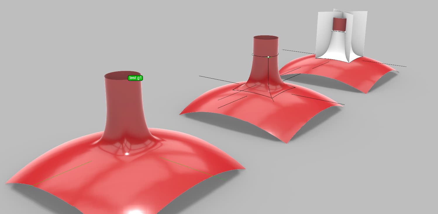

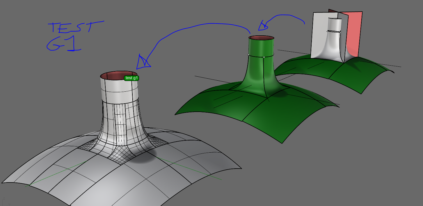

test in g1 with fillsrf, alternative
CP_2025-05-14_fillSrf_trim_test g1.3dm (1.0 MB)

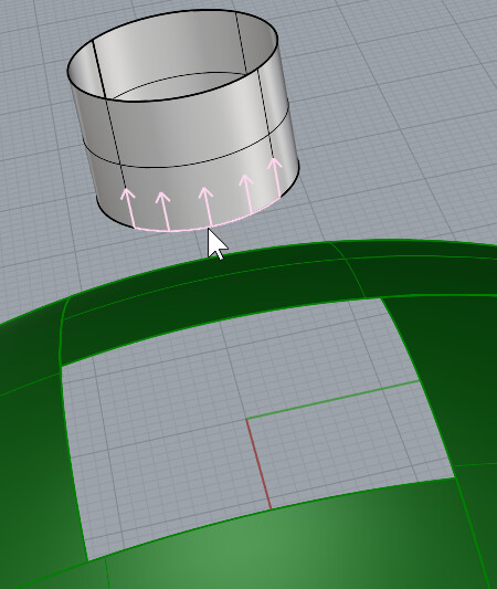

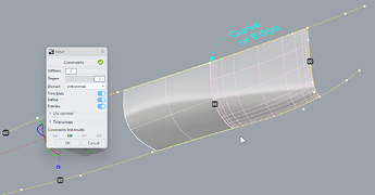

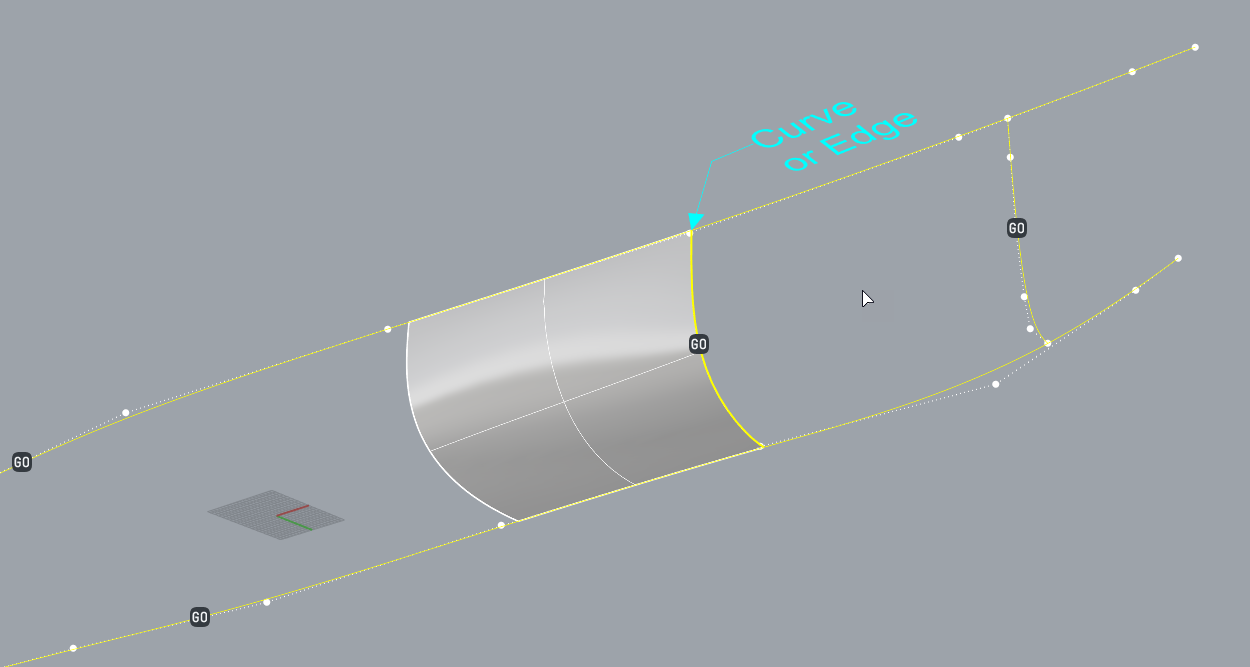

In a 4 sided situation like this, I get different results when I select a curve or an edge.
The constraints are all G0.
The area where the mouse pointer sits is to be filled.
Using the the curve I get the expected result:
With the edge:
I expected an edge with G0 would behave the same as the curve.
2025-05-15_Fillsrf_C.3dm (853.5 KB)
I think this is why you get different results:
Urgs.
Didn’t notice the deviation.
Sorry.
np, keeps us sharp :slight_smile:
