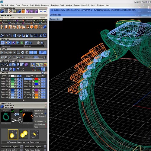

I remember old Matrix 7.5 and 9 having a Boolean Builder Tool, with a few tricks to overcome some of the dificulties Rhino has with Booleans, especailly in the jewelry area, where sometimes you could have hundreds of cutters on several intersecting polysurfaces.
More experienced modelers got around boolean limitations beign mindful when building up the model, but even then, jewelry can get messy and the objects can get heavy (flow on surface, mesh objects mixed with polysrfs, cage manipulation, scultural features, etc…).
In old Matrix, when the option “One by One” was on, you could see it go trough each difference operation, cutter by cutter, and to avoid memory limit crashes that were common in 32bit, the tool would do aClearUndo for each cut, and it would highlight the problematic cutters if some of them failed to do the cut.
I couldn’t find a video, but that whole process made it very easy to troubleshoot when needed.
