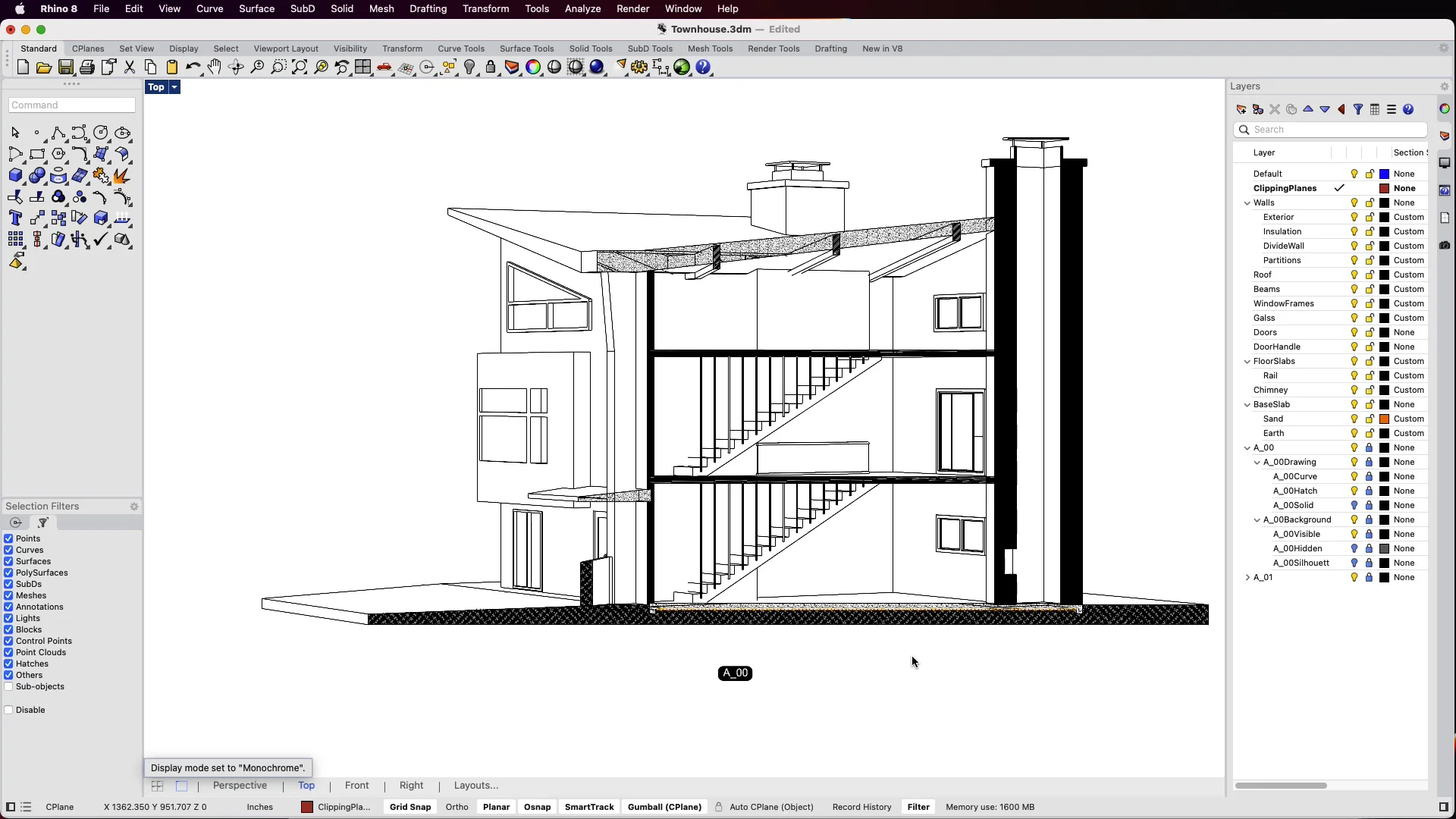

Hi everybody,
I’ve just downloaded rhino 8. I’m testing the Clipping Planes tools.
Is there a fast/easy way to extract the section lines including also what is behind the Clipping Plane?
If I use “make 2d” I obviously lose all the hatches and the combine use of extraction of the Cllipping Plane section + “make 2d” it is not fluent at all.
Thanks for your support
Thank you for your quick answer!
ClippingDrawings is great, but it’d be nice to be able to turn them into independent vectors, ala Make 2D, and have it preserve all the background, hatches etc. Feels like it’s a missing piece of functionality. Quite often - when creating working drawings for furniture - I hand edit the 2d representation to help clarify things.
The clipping drawings are vector drawings, you can always unlock the layers and make a copy to edit, dimension, etc. Would that work for you?
Ah, brilliant. Somehow I hadn’t spotted that - it’s just what I needed. Thanks.
