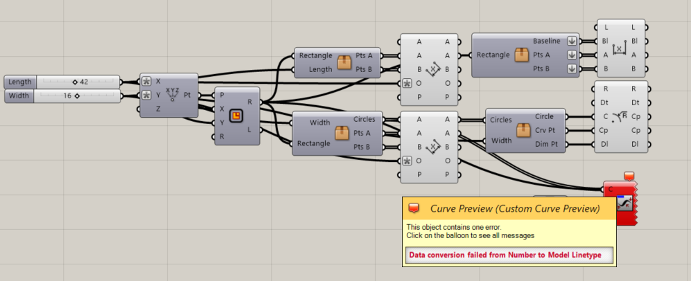

Hi, I just downloaded the Annotations.gh file to try. Upon opening in GH, the Curve Preview component popped up the following error: ā€œ1. Data conversion failed from Number to Model Linetypeā€. What should I do about this?
FYI, I am new to Rhino 8 and GH in general.
Thanks for the help!
I think from the screenshot you posted, you were talking about the ā€œSimple Dimensioned Partā€ example. I searched and couldn’t find that file attached anywhere in this thread, but I did have a copy of it on my machine. All that was needed was to replace the Number Parameter with a Model Linetype component. I’ve swapped out those components and you can download the fixed model here.

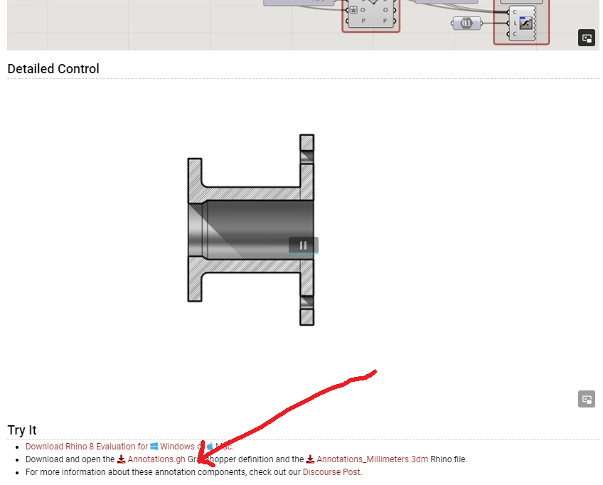

Sorry @AndyPayne , I should have included the link.
Go to the bottom of the page:
The linetype component you added has worked for displaying the plate in this example (rectangle w/ 3 holes), but perhaps not for creating these shapes? I am not able to bake the whole thing, plate and annotations for exporting to another program. Can you help with that? Much thanks!
To bake things into the document, you can use the new Content Cache component. Simply pass whatever content you want to push to the document into the C-input and then set the P-input to True to bake every time you make a change. Like this.
Annotations_Bake.gh (29.0 KB)

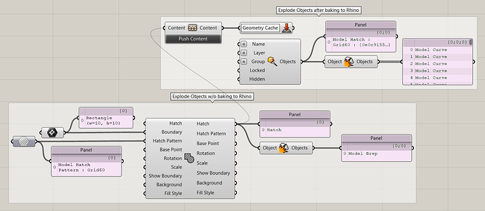

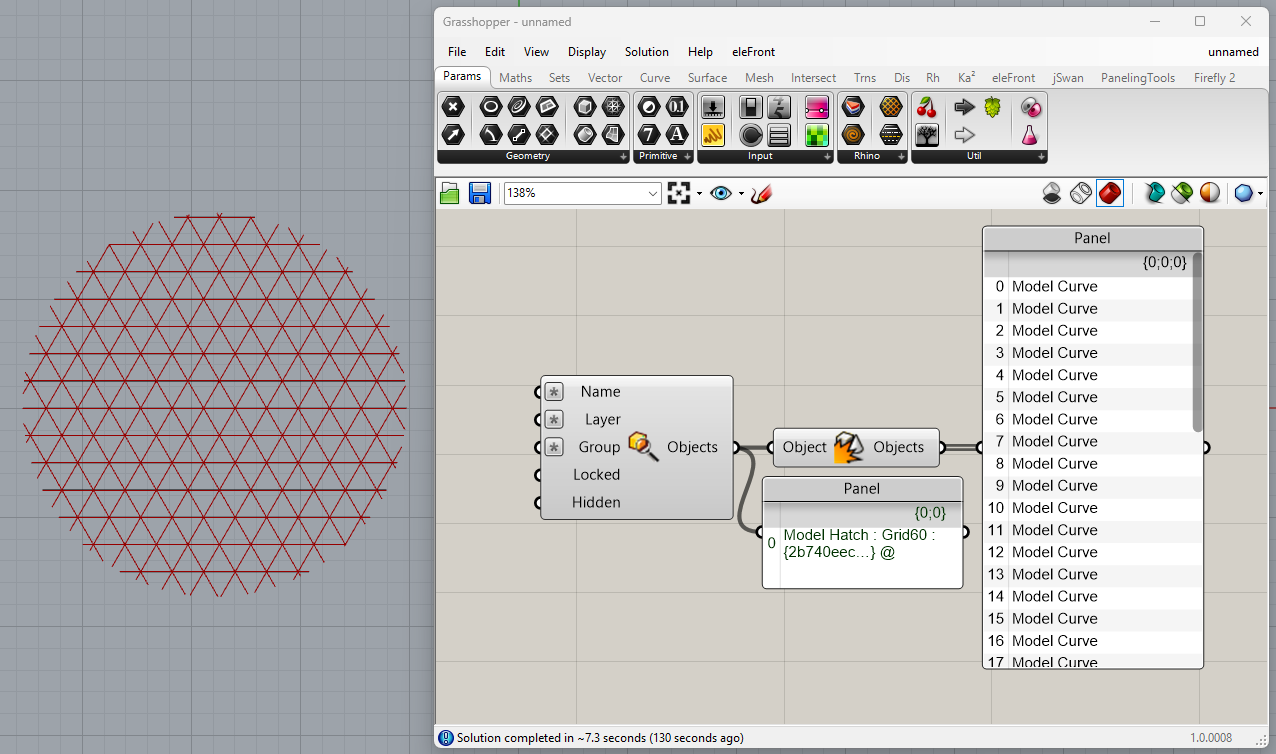

@John_Leahy Does the explode component not return the lines of the hatch pattern? If not, can you post a simple definition that does not work correctly? In my test, it appears to be working as expected.
@AndyPayne My apologies for not posting a screen shot earlier.
When the Hatch Pattern input is set to Grid 60, shouldn’t Explode Object output the lines/curves created by Model Hatch? Model Brep would be accurate if the Hatch Pattern had been defined as Solid, so perhaps there is an error with Model Hatch? Possibly the Background and Fill Style inputs/outputs are not actually empty? If not, then why must a hatch be baked first to Rhino for Explode Object to function properly?
My suggestion was that it might be helpful to include an output parameter for Hatch Geometry between Hatch and Hatch Pattern since many other parameters are passed through the Model Hatch component. This also makes me wonder if Show Boundary is actually useful since the input parameter for Boundary could just be used.

@John_Leahy Thanks for reporting this. I found the bug and this will be fixed in the next 8.6 release (next week).
