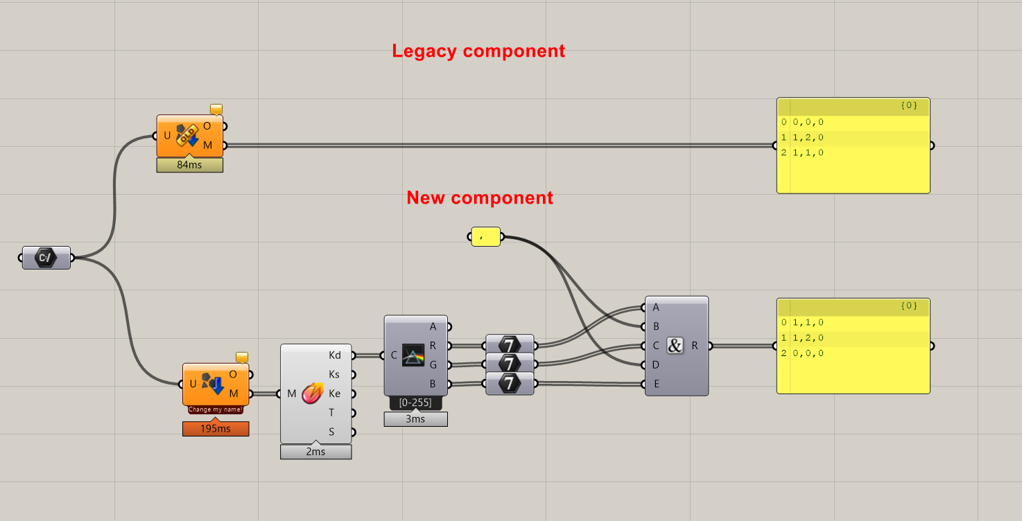

Please see the screenshot below to compare the behavior across versions:

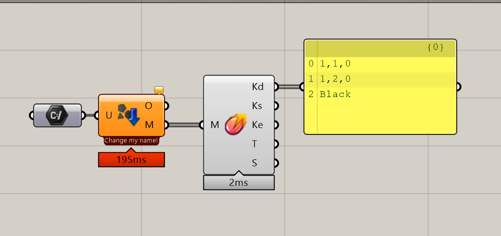

That said, is there any easy way to turn off the color name translation in the new import component?
I think the color name translation is a “feature” of GH_Colour when it gets cast to a string. Can you avoid the casting?
Hi Alex!
Lets keep it simple, how to get rid of “black” from the list?

Here is my approach, it is clearly show why I do prefer the legacy way. Or do I miss something?
Why do you want to get rid of the “Black” color? As Alex said, this is just a matter of the way colors in Grasshopper are cast to strings, but the component outputs a real color which can then be used further in your definition for whatever purpose you are interested in. In other words, it should not have any impact on your workflow.
As a matter of fact, the old Import component was using an external algorithm, whereas the new one imports objects and materials using only Rhino functionalities.
I am embedding a metadata trough RGB channels, as back in the times it was the only way to describe what is inside the imported 3D model. We build up the whole system base on this. At the moment there would be more convenient paths I am sure.
Got it. Given that this behaviour is the standard one in Grasshopper, I think the workaround from your screenshot above is the best solution at the moment. It would indeed make sense in the future to revisit your workflow making use of the most recent feature or Rhino 8/ShapeDiver.
