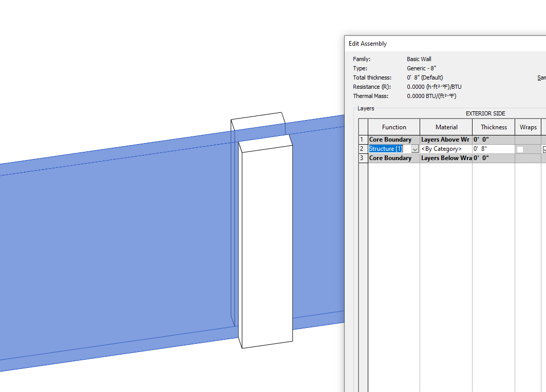

It hard to give a good answer without additional information. Can you post a small example of the condition in Revit? Thanks.
It seems like you would change the structural priority for the cleanup.

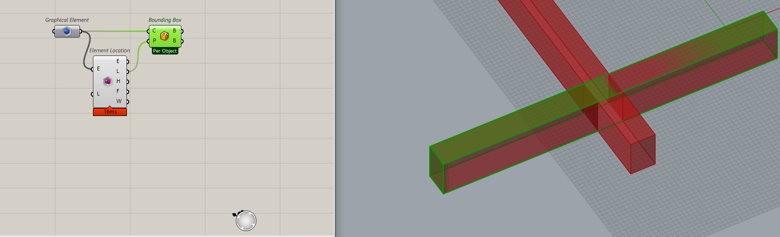

Hi @Japhy
Here’s the file I made.
BEAM JOIN GEO.rvt (1.5 MB)
BEAM JOIN GEO.gh (9.6 KB)
Japhy
(Japhy)
May 19, 2023, 1:14pm
6
In this case you can get a bounding box of the Element, using the element plane ensures non-xy oriented beam get output correctly.

Here I used simple rectangular as beam profile,
But for future cases, like say different shape (I-beam, or rounded) then bounding box won’t be satisfied.
Japhy
(Japhy)
May 19, 2023, 2:52pm
8
You’ll need to split or unjoin your Revit Elements then.
