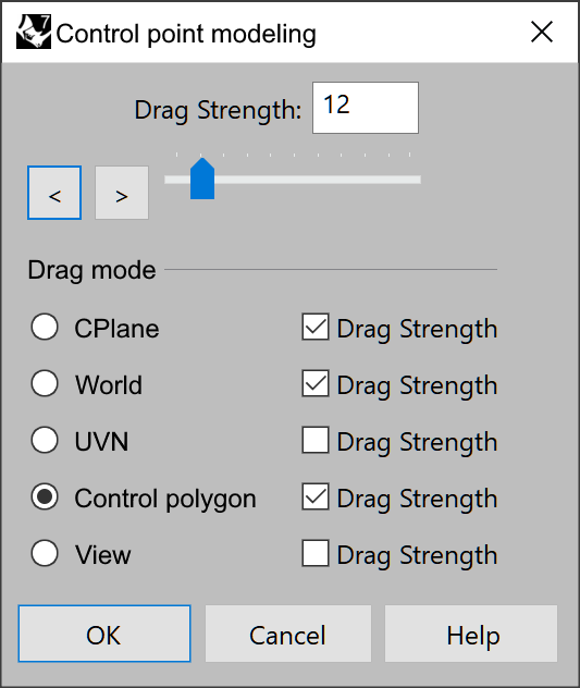

A dedicated “Control point modeling” panel with better “Drag strength” consisting separate settings for each type of editing:
