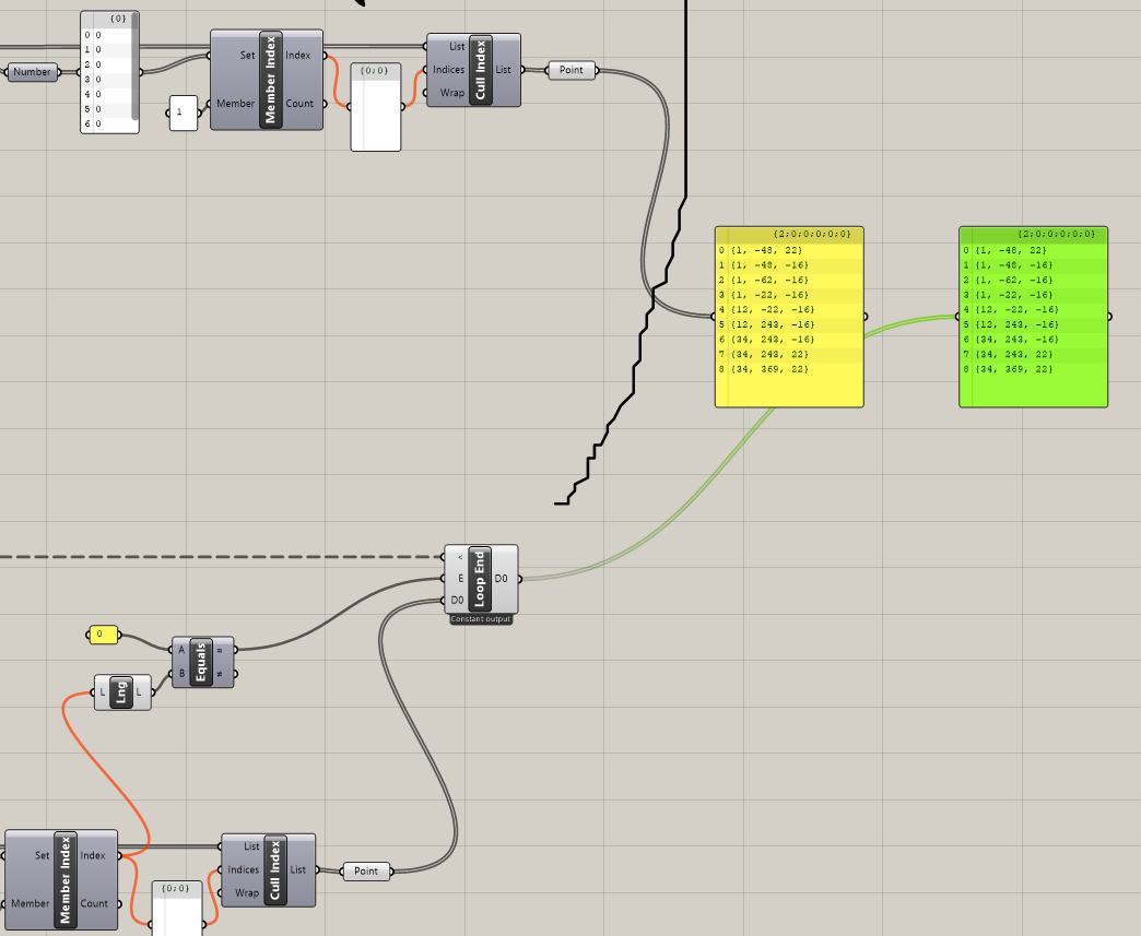

I’m not sure if Anemone is the right tool for this, but I want to repeat a certain block of components until the list at the end becomes empty.
Is it possible? I’m not really familiar with looping and can’t figure it out how it works.
Attached a sample file, in brackets, there are the repetitions, please ignore them, I just wanted to show what should come next, when I put the components after the first block again. This is not the only case I would use it, so I don’t know how many times the steps should be repeated, but know only, that until the list becomes empty.
Thanks!
repeat_task.gh (32.9 KB)
just took your def and put it behind the Loop Start and Loop End, looks like it’s working, results are the same :slight_smile:
exit condition is this list Length = zero:
maximum number of repetitions I have used the Length of the initial list of points:
repeat_task_Re.gh (43.7 KB)
oh, really cool, thanks a lot! :slight_smile:
