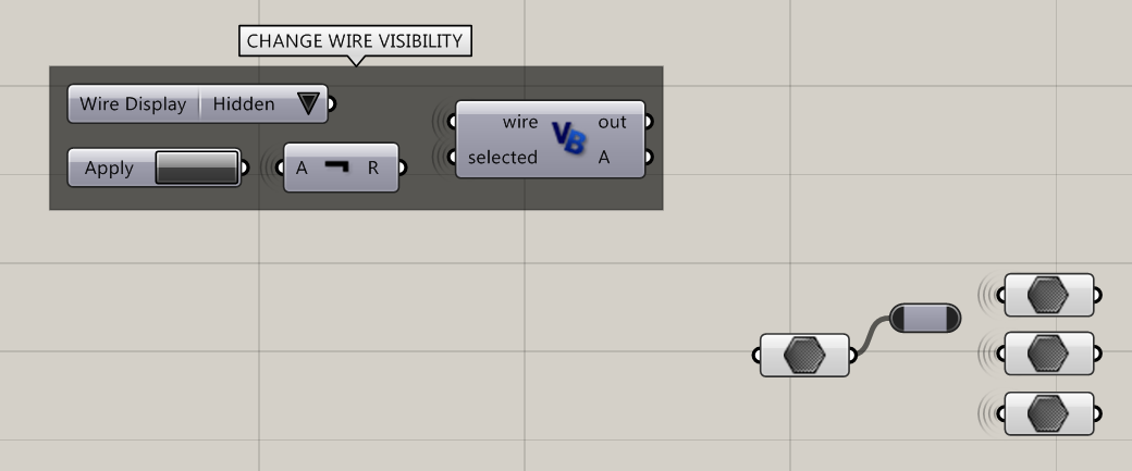

I too mainly use faint wiring simply to keep visual clarity and in some patches its rather dense with wires as this demonstrates:
Back in the old forum I found this handy visual basic script to globally change all wire display styles, which is now in my startup template because it’s so useful. I’ll include it here in case anybody might need it.
change_wires_globally.gh (4.4 KB)
nice find!
still doesn’t work on damn relays :thinking:
also tried with @andheum 's metahopper , but no luck
