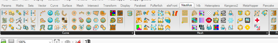

Hi Laurent,
I cannot find the ‘region to mesh’ component in Nautilus (I just updated throug package manager).
But great that you developed such a tool!
Kind regards
I am a bit surprised, but I quite never install the release I send as I use the development folder.
Just to be sure did you see this. The 0.9.4 ?
In red the new components
If not I can send the tool by PM

Hi Laurent,
→ different layout, and I do not see an image section…
I restarted Rhino several times and checked the plugin folder, but no changes.
Thanks again,
I surely messed up !!! I try to correct it now.
It must be good now! 0.9.4.1
Works like a charm! What a difference in performance…I’m saved :slight_smile: !
Thank you very much!
